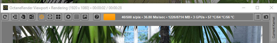

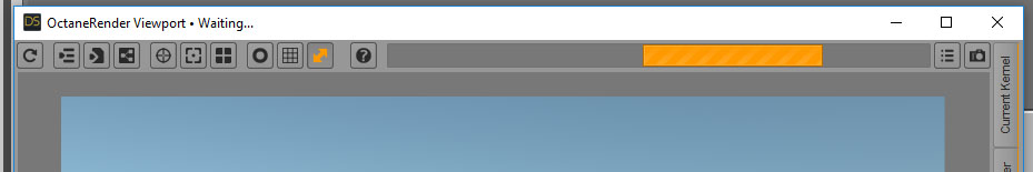

Hi Paul,
Just tried it. My 2080 TI was recognized
Noticed something in Render Window : it is rendering, but the top area has the running yellow bar and the status shows Waiting...
Will update if I see something else.

Yes, same here, no way of knowing when the render has finished unless you leave it as long as an iRay render would take... like... for-eve-ver.rajib wrote:Hi Paul,
Just tried it. My 2080 TI was recognized!
Regards,
Rajib

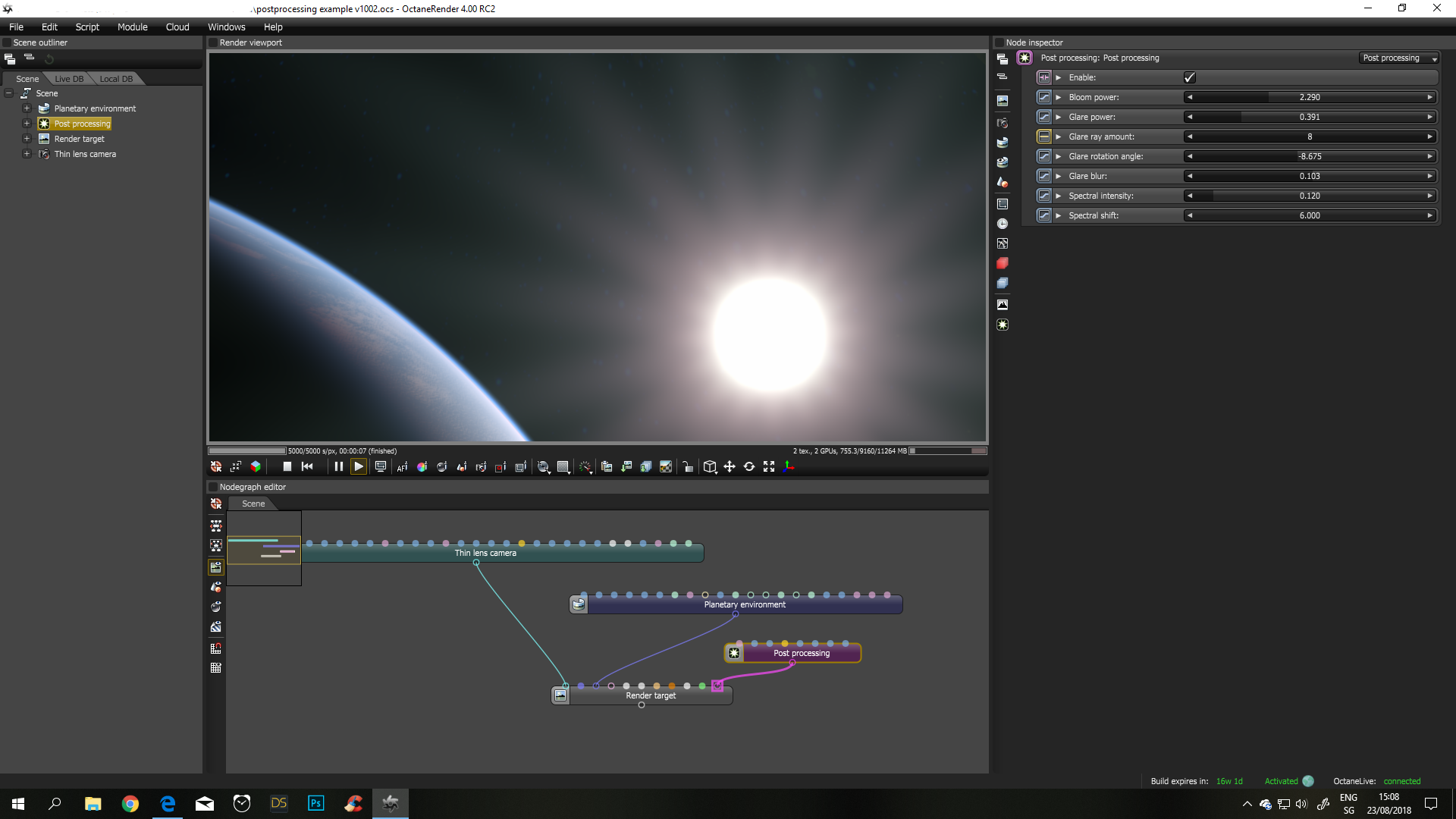

Can the Planetary Environment be supported in the DAZ Studio plugin?
Or will it fall under the same limitations as the not available Visible Environment options like backplate, reflections and refractions?

Thanks for reporting this. You are right - this is an issue. This will be quite difficult to fix, so will take some time to resolve.Noticed something in Render Window : it is rendering, but the top area has the running yellow bar and the status shows Waiting...
Yes, in the short term it will be unsupported as per the Visible Environment, but it is on the long-term list for implementation.Can the Planetary Environment be supported in the DAZ Studio plugin?

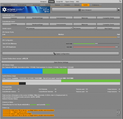

Hi Paul,
Got the following error while basically switching between Octane tab and the Daz Viewport. Btw. Every time I switched from the Octane Pane to the Daz Viewport, the Octane render window would hang for a few seconds and then continue rendering. This happened a couple of times and then it stop rendering and I saw the following in the System Tab. I was also editing the Materials in the NGE on and off.
10:18:35.123: +++++ Plugin running.
11:01:06.956: CUDA error 700 on device 0: an illegal memory access was encountered
11:01:06.958: -> failed to download symbol(stats data)
11:01:06.960: device 0: path tracing kernel failed
11:01:07.016: CUDA error 700 on device 1: an illegal memory access was encountered
11:01:07.016: -> failed to wait for event
11:01:07.016: device 1: path tracing kernel failed
11:01:07.016: CUDA error 700 on device 0: an illegal memory access was encountered
11:01:07.016: -> failed to set texture format(__data24__)
11:01:07.017: -> failed to set texture format(__data26__)
11:01:07.017: CUDA error 700 on device 0: an illegal memory access was encountered
11:01:07.017: -> failed to set texture format(__data29__)
11:01:07.017: -> failed to set texture format(__data30__)
11:01:07.017: -> failed to set texture format(__data27__)
11:01:07.018: CUDA error 700 on device 0: an illegal memory access was encountered
11:01:07.018: -> failed to deallocate device memory
11:01:07.018: -> could not get memory info
11:01:07.019: CUDA error 700 on device 0: an illegal memory access was encountered
11:01:07.019: -> failed to deallocate device memory
11:01:07.019: -> could not get memory info
11:01:07.020: -> could not get memory info
11:01:07.020: CUDA error 700 on device 0: an illegal memory access was encountered
11:01:07.020: -> failed to deallocate device memory
11:01:07.021: CUDA error 700 on device 0: an illegal memory access was encountered
11:01:07.021: -> failed to deallocate device memory
11:01:07.021: -> could not get memory info
11:01:07.021: Render engine failure occured! (WARNING)
11:01:07.022: CUDA error 700 on device 2: an illegal memory access was encountered
11:01:07.066: -> failed to wait for event
11:01:07.066: device 2: path tracing kernel failed
11:01:11.157: Render engine failure occured! (WARNING)
11:01:14.156: Render engine failure occured! (WARNING)
