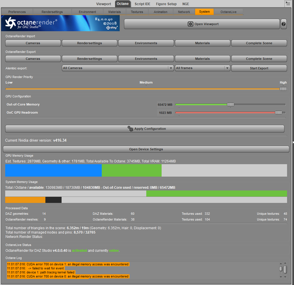

Hi Paul,
Got the following error while basically switching between Octane tab and the Daz Viewport. Btw. Every time I switched from the Octane Pane to the Daz Viewport, the Octane render window would hang for a few seconds and then continue rendering. This happened a couple of times and then it stop rendering and I saw the following in the System Tab. I was also editing the Materials in the NGE on and off.
10:18:35.123: +++++ Plugin running.
11:01:06.956: CUDA error 700 on device 0: an illegal memory access was encountered
11:01:06.958: -> failed to download symbol(stats data)
11:01:06.960: device 0: path tracing kernel failed
11:01:07.016: CUDA error 700 on device 1: an illegal memory access was encountered
11:01:07.016: -> failed to wait for event
11:01:07.016: device 1: path tracing kernel failed
11:01:07.016: CUDA error 700 on device 0: an illegal memory access was encountered
11:01:07.016: -> failed to set texture format(__data24__)
11:01:07.017: -> failed to set texture format(__data26__)
11:01:07.017: CUDA error 700 on device 0: an illegal memory access was encountered
11:01:07.017: -> failed to set texture format(__data29__)
11:01:07.017: -> failed to set texture format(__data30__)
11:01:07.017: -> failed to set texture format(__data27__)
11:01:07.018: CUDA error 700 on device 0: an illegal memory access was encountered
11:01:07.018: -> failed to deallocate device memory
11:01:07.018: -> could not get memory info
11:01:07.019: CUDA error 700 on device 0: an illegal memory access was encountered
11:01:07.019: -> failed to deallocate device memory
11:01:07.019: -> could not get memory info
11:01:07.020: -> could not get memory info
11:01:07.020: CUDA error 700 on device 0: an illegal memory access was encountered
11:01:07.020: -> failed to deallocate device memory
11:01:07.021: CUDA error 700 on device 0: an illegal memory access was encountered
11:01:07.021: -> failed to deallocate device memory
11:01:07.021: -> could not get memory info
11:01:07.021: Render engine failure occured! (WARNING)
11:01:07.022: CUDA error 700 on device 2: an illegal memory access was encountered
11:01:07.066: -> failed to wait for event
11:01:07.066: device 2: path tracing kernel failed
11:01:11.157: Render engine failure occured! (WARNING)
11:01:14.156: Render engine failure occured! (WARNING)
Available memory seems to be ok. It is a light weight scene.
