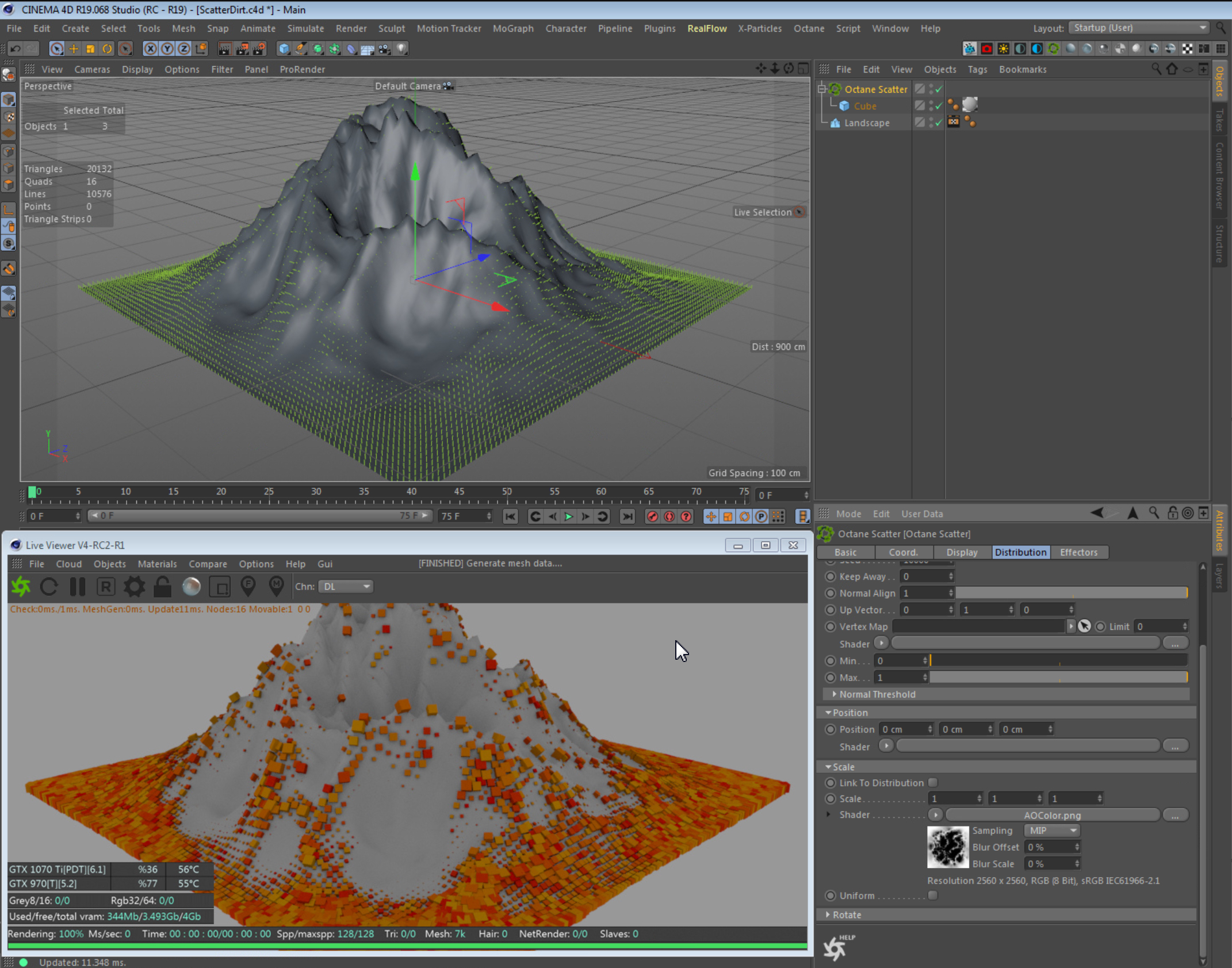

i am trying to use scatterer with dirt to drive the position of the instances.
dirt goes through colour correction a mix map.
i thought i might copy it into the shader under parameters. cant seem to find a way.
i hope someone can help me.
Posts: 10563

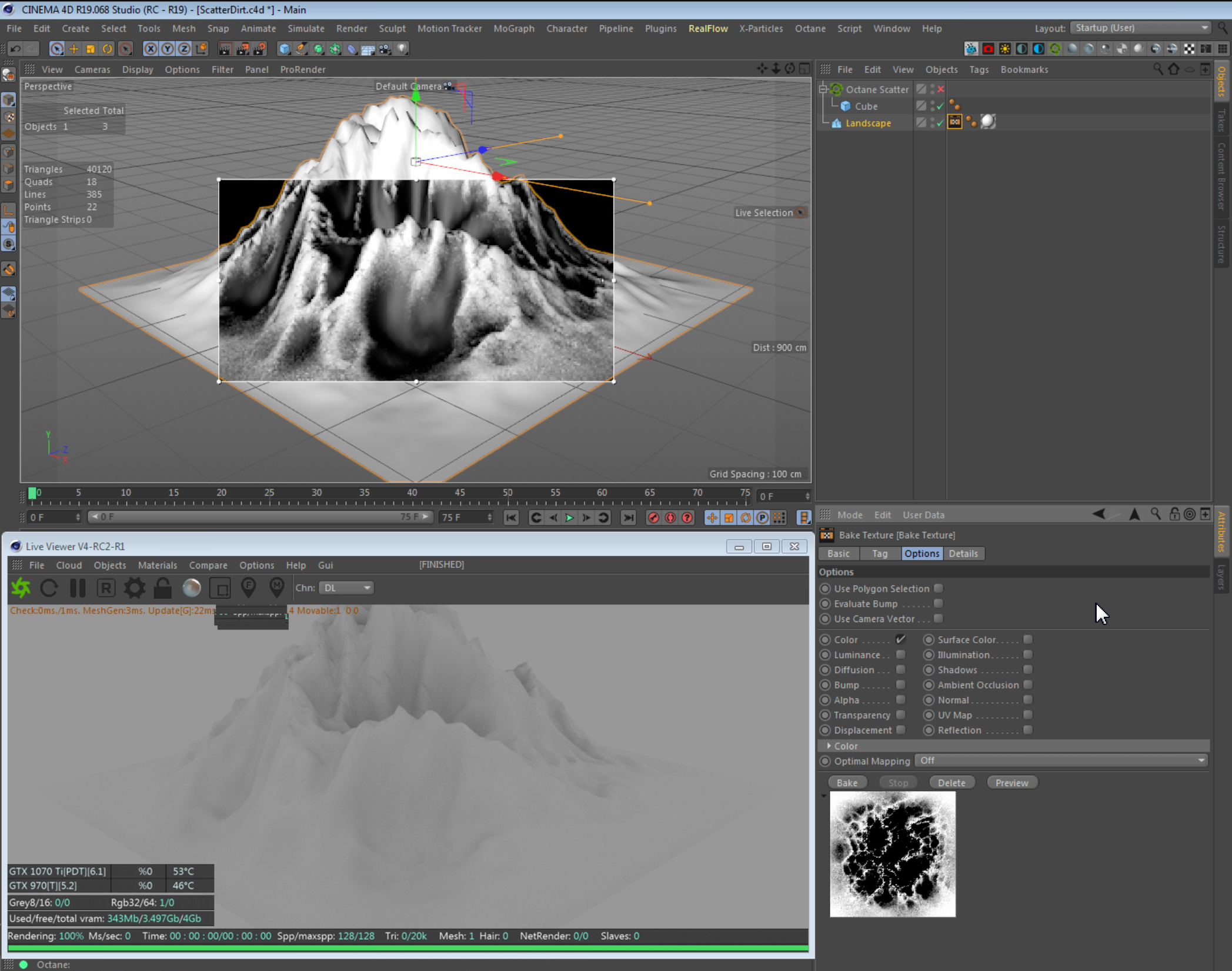

you can use a c4d AO shader to obtain a baked map:
and then use the map to scale/distribute the clones:

fantastic,
i was trying to bake from octane, did not know how the c4d tag worked.
