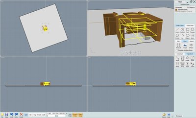

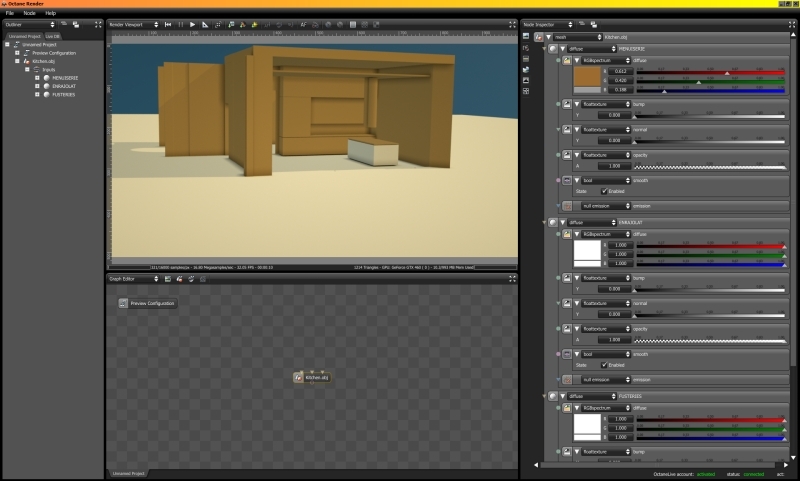

Hi Waterthinking,
I'm not sure if you've resolved your problem, so if you have ignore this post. I imported your file into Moi3D. The model came in fine. I'm not sure how you exported, but there was some interesting geometry in the 3DM. I cleaned it up, renamed the objects and imported into Octane with Triangles only.
See the attached images, and I've attached the Obj file as well. If you need a hand with conversion let me know.
Kind Regards
Charles'

Object file imported into Octane.
Original 3DM file imported into Moi3d.
