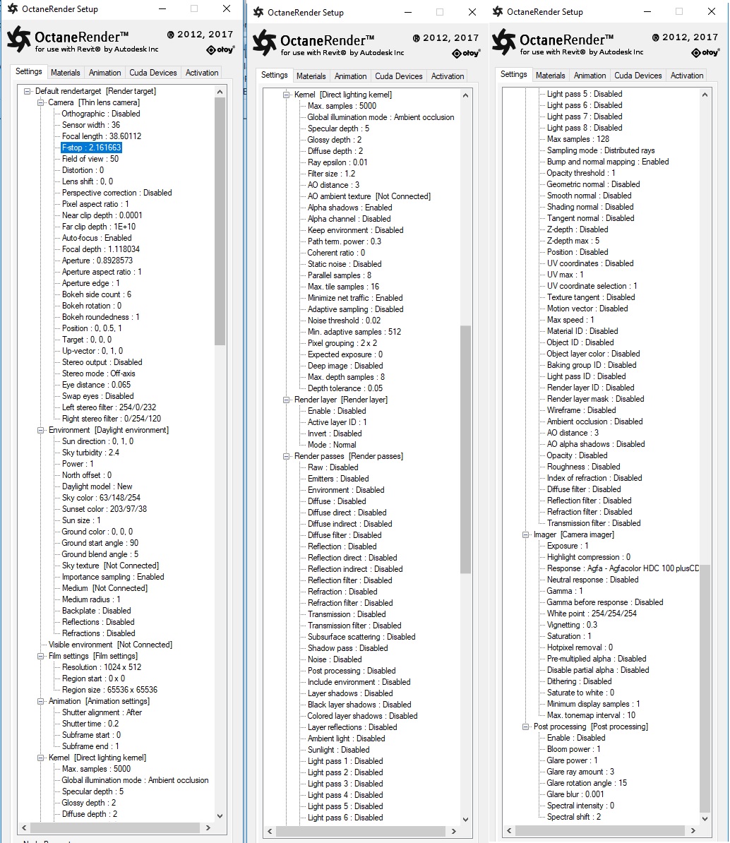

Where can I find this in the settings? I went through it all twice and could not find it. Using release 3.7.0.51.VR on Revit 2018.
Is it in the camera, env, film, animation, kernel, layer, passes, imager or post-processing settings?
face_off
Posts: 15827
Location: Adelaide, Australia
It is in the Configuration panel (click the Setting button to open it).
Paul
SamuelAB
Posts: 168
Joined: Sun Apr 15, 2012 8:25 pm
Hi Paul,
I do not see it. Could you tell me what category it is under or circle it in the image?
I've read this list 2-3 times by now and I cannot find it.
SamuelAB
Posts: 168
Ah, nevermind. I found it. I got confused because there is a Setting tab and a Setting button.
