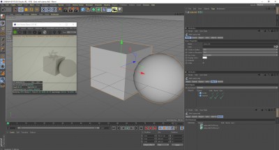

Hi, I have file with basic materials (no textures, only with color in diffuse and different index etc.)
If I load file to Xref, object is without any materials. If I look at "XRef M" in the "XRef" there I can see materials, but in LiveViewer there is only flat model.
Thanks a lot.
XRef with no materials

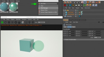

I'm on R17, and when I use Create > XRef > Add XRef and load your scene, it seems to work right.
Have things changed in R19 perhaps?
OSX 10.12.4 | Intel 12 core @ 3.33 ghz | 128 gb ram | NVIDIA GeForce GTX 1080TI | Ubuntu Linux slave with 3x 1080ti
Yep, I was suspicious when I saw the screen cap you posted, Mibu . You've used the legacy Xref, as opposed to the current system. If you follow the steps outlined by nietsudio, you should be good to go.
