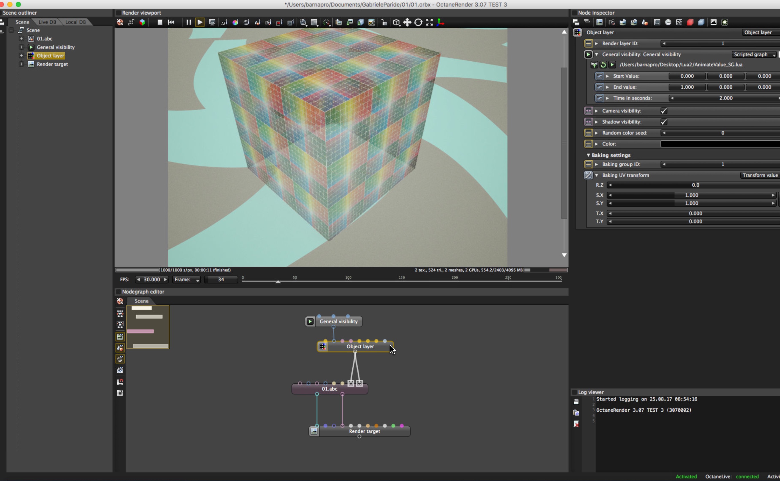

is there a visibility node that could be controlled by this animation script by any chance?
I have an ABC node going in and I want to make it invisible until a certain time ... besides opacity node in the shaders that go into it... is there a way to do that?

						Hi Peter,
you need an Object Layer node connected with all the .abc related pins. In this way you can animate the General Visibility with the Animated Value scripted graph: ciao beppe

Thanks as always Bepe
what are those two nodes you have that the object layer is going into ?
When I export an ABC I do not have the ability to put an object layer in
						If you export as ORBX (with embeded Alembic option) from the Octane for Maya plugin, it's possible to export object layers,p3taoctane wrote: When I export an ABC I do not have the ability to put an object layer in
but as usual with the Maya plugin it's very clunky :
- set the Octane Bake ID from 0 to 1 for every shape you need an object layer for.
Anyway you could also just animate the Octane Visibilty parameter directly in Maya before exporting then you don't need to script the animation in Octane SA.

Thanks Calus
Yes you are right very clunky I will give your suggestions a try.

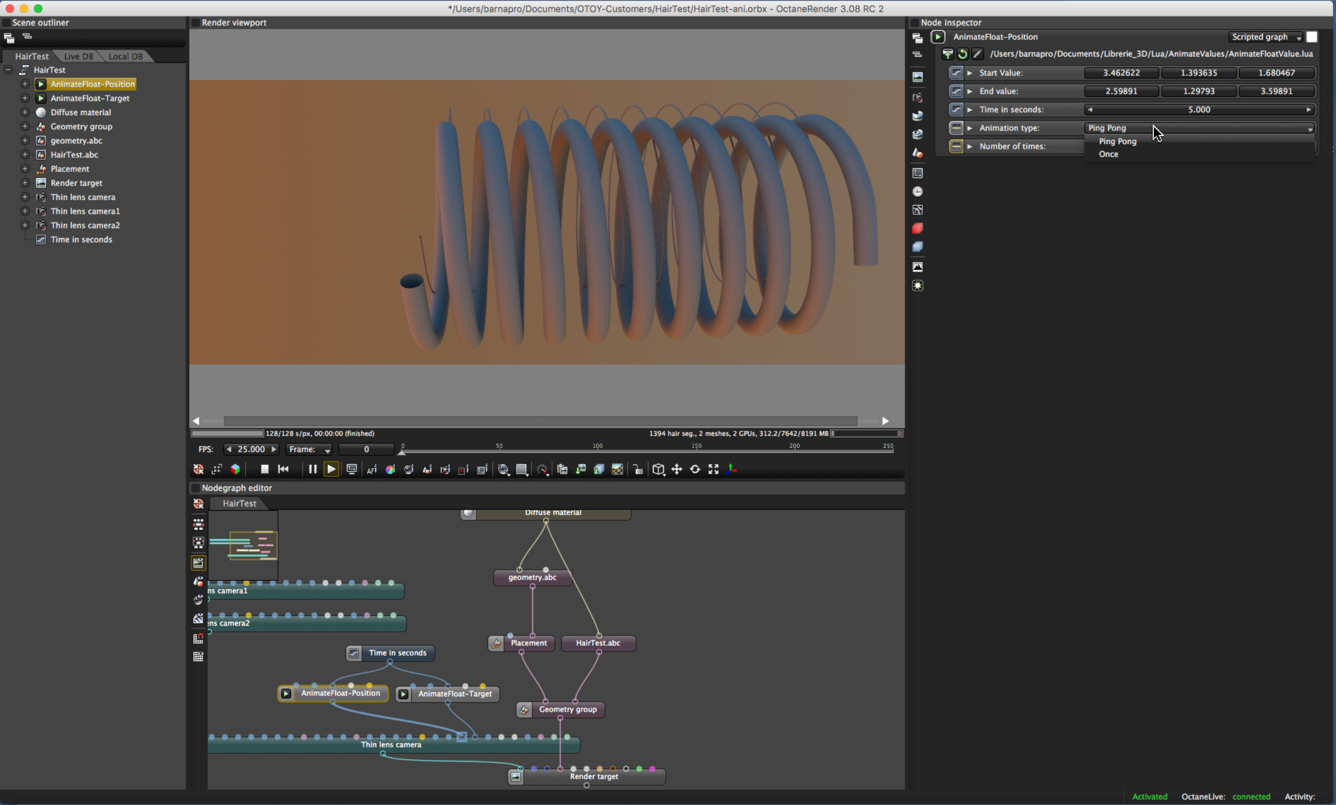

yes, you can use it to move a camera from A to B, and eventually go back to A, with the Ping-Pong option active.
You need to use two AnimatefFloatSG, one for the Position Value, and the other for the Target value,, and copy paste the start and end values from two camera nodes. Please, have a look at this example (sorry for the basic quality): ciao Beppe
unfortunately it is not possible, as said, only from A to B, or A to B to A, sorry
ciao Beppe
ciao Beppe
