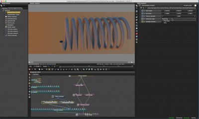

Posts: 10646
yes, you can use it to move a camera from A to B, and eventually go back to A, with the Ping-Pong option active.
You need to use two AnimatefFloatSG, one for the Position Value, and the other for the Target value,, and copy paste the start and end values from two camera nodes. Please, have a look at this example (sorry for the basic quality):
hairtest-anisg.orbx.zip
(17.22 KiB) Downloaded 964 times
ciao Beppe
