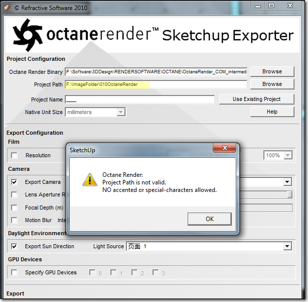

Hi Tig,
I have both SU 7 and 8 installed.
I installed the SU plugin on both directories.
Su7 is able to launch the dialog box and render and V8 doesn't.
I think it worked at one point, but not anymore.
I tried rebooting etc.. but to no avail.
I tried going back to 1.05 but same thing...
Some more info:
When trying to launch Octane from SU8 with an empty scene I get the dialog box "You must save this...."
This is good !
But when I create a simple scene (a box) and save it, clicking on the octane icon doesn't so anything and the icon stays depressed.
The file name and the directory path do not have spaces or foreign characters.

The 'special-character' check/error-message was introduced in this version to trap problem with Sketchup's Ruby's ability to process Unicode characters in file-names/paths.
If you revert to version 1022-05 do you still get this problem ?
Having file-paths and project-names with 'ASCII' characters [A-Za-z0-9_-] should always work - can you ensure that they are have that format and retry with this version - post any error [or success] stories...
