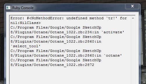

TIG,
With version 06 i get the same error messages like i had with version 05, when i replace it with version 04 everything works.
Error: #<Exception: Invalid Dialog>
C:/Program Files/Google/Google SketchUp 8/Plugins/Octane/Octane_1022.rb:2288:in `get_element_value'
C:/Program Files/Google/Google SketchUp 8/Plugins/Octane/Octane_1022.rb:2288:in `getIDvalues'
C:/Program Files/Google/Google SketchUp 8/Plugins/Octane/Octane_1022.rb:2288:in `each'
C:/Program Files/Google/Google SketchUp 8/Plugins/Octane/Octane_1022.rb:247:in `deactivate'
C:/Program Files/Google/Google SketchUp 8/Plugins/Octane/Octane_1022.rb:2860:in `select_tool'
C:/Program Files/Google/Google SketchUp 8/Plugins/Octane/Octane_1022.rb:2860:in `octane'
C:/Program Files/Google/Google SketchUp 8/Plugins/Octane_1022.rb:2861
Error: #<NoMethodError: undefined method `tr!' for nil:NilClass>
C:/Program Files/Google/Google SketchUp 8/Plugins/Octane/Octane_1022.rb:234:in `activate'
C:/Program Files/Google/Google SketchUp 8/Plugins/Octane/Octane_1022.rb:255:in `select_tool'

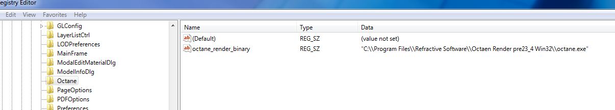

Have you tried deleting the relevant registry entries for the WebDialogs as I explained in the other post ?

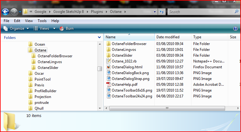

It's working fine for Sketchup Pro 8 [in fact it was tested many weeks ago, even before that version was made public...]
Here's a screen-shot of the file/folder structure needed in v8 [which is the same as v7] - for the avoidance of doubt...
You should also have the loader Octane_loader.rb, deBableizer.rb and FixReversedFaceMaterials.rb in the ../Plugins/ folder itself.
The sub-folders listed should contain several other files, as itemized in the README...
PS: You do need Admin rights etc to make changes to files/folders inside 'Program Files'... I know in Vista it's possible to think you've moved/updated files - as they look as if they are in the right place... BUT they are actually held in a 'compatibility files' folder waiting for an Admin to move them over 'properly'... I don't know if that might be the case in your OS ?

Can you open the Ruby Console and the run the Octane Render tool and report any error-messages.
Can you also screen-shot the error message you are getting otherwise...

Have you looked at the Registry entries as mentioned in earlier posts - can you take a screen shot of that too...

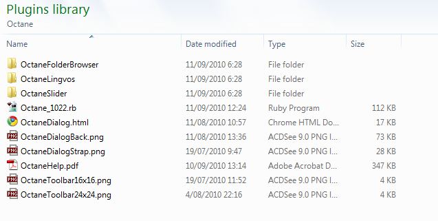

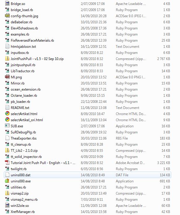

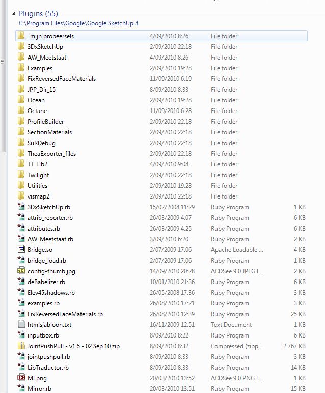

GuyWydouw
Posts: 17
Joined: Sun Aug 29, 2010 8:01 am
TIG,
I hope you can find the problem...
regards,
Guy
Windows 7 32 bit | SketchUp 8 Pro | VectorWorks 2008 | Twilight Render | Octane Render | Quad 2.50 Mhz | 3GB | Nvidea GeForce 250 GTS 512MB
