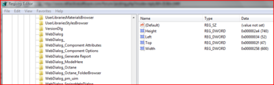

That all seems to be in order BUT you missed out the registry entries fro the Web-dialog it should look like this [Google > Sketchup 8]
I suspect it will look like this ?
try deleting that entry and trying SUp & the Exporter again...
I notice your default browser is 'Chrome' - can you change it temporarily to IE or FireFox and see if that has any affect...
It shouldn't but I have no better ideas right now :roll:
Thanks for you patience - we will get this fixed. :geek:

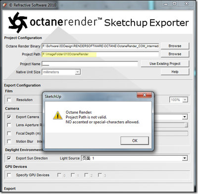

After browsing for project path and delete the spacing but exporter keep telling me this. So please TIG what can I do.
Previous folder name was in chinese but later i changed to new path with english based folder. It's that causing this problem?
Thank you TIG

TIG,
This seams to be the problem
When i remove all the registry items and i restart sketchup and execute octane again. New registry items are build but still the size and position of the dialog are missing....

9fly
The 'special-character' check/error-message was introduced in this version to trap problem with Sketchup's Ruby's ability to process Unicode characters in file-names/paths.
If you revert to version 1022-05 do you still get this problem ?
Having file-paths and project-names with 'ASCII' characters [A-Za-z0-9_-] should always work - can you ensure that they are have that format and retry with this version - post any error [or success] stories...

Guy
That Registry entry is now incomplete because the webdialog is failing to load completely - for some reason.
The long Console error-messages are simply a secondary result of the webdialog not being available...
