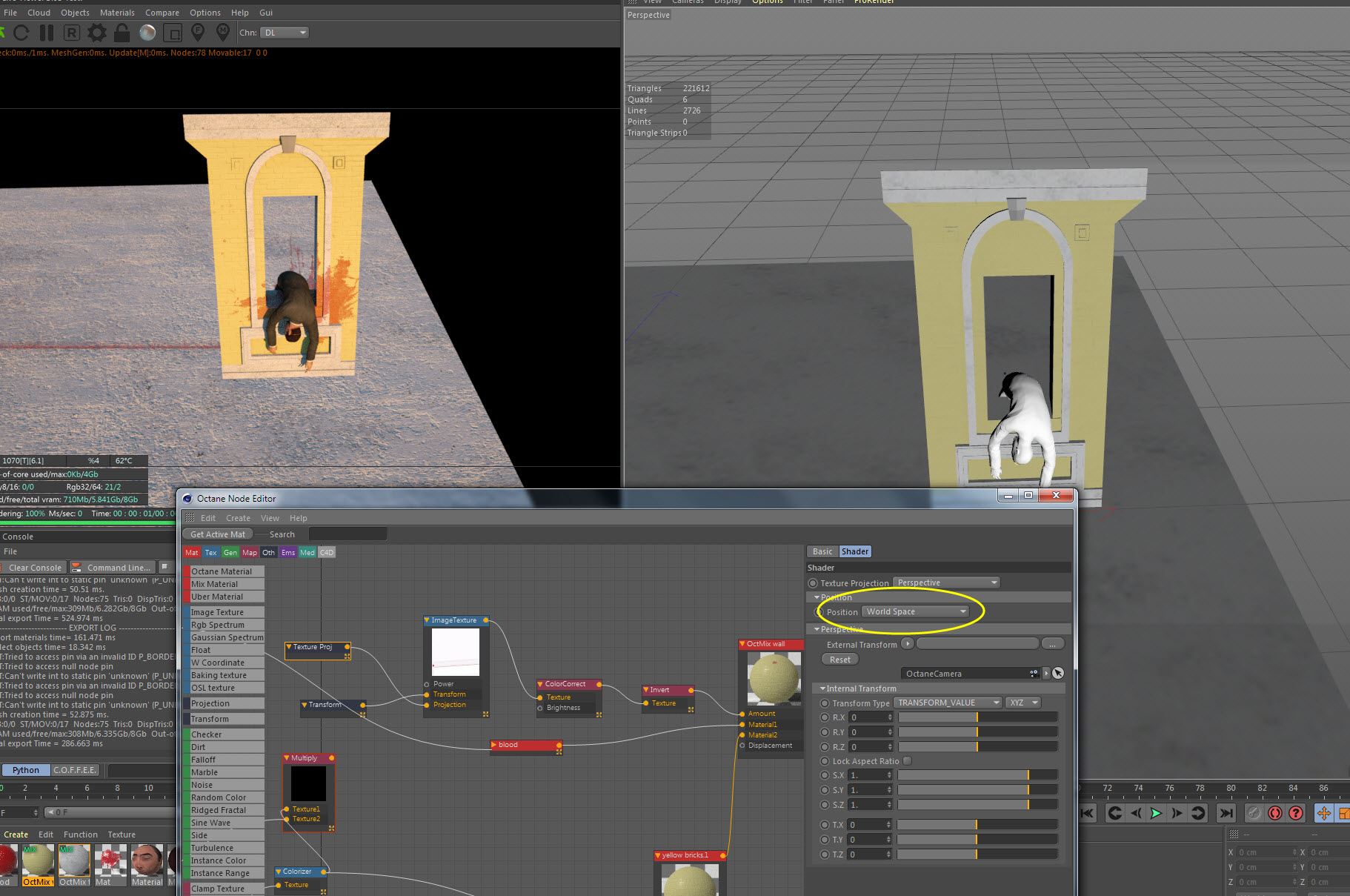

You should use "world coordinate" for cameramapping with this way. see image

aoktar wrote:You should use "world coordinate" for cameramapping with this way. see image
Ahah! That fixed it completely. Thanks so much!
