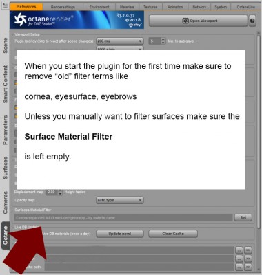

Update 2018 - 03 - 19:
When you start the plugin for the first time make sure the
Surface Material Filter
is left empty when you intend to work with the figure generations of Genesis, Genesis 2, Genesis 3, Genesis 8.
If you are working with Victoria 4.2 and Michael 4 you may still want to use the entries
cornea, eyesurface, eyebrows
Make sure the Surface Material Filter is empty by default
A more detailed description about figure generations and their surfaces can be found here
viewtopic.php?f=44&t=30362&start=10#p333646

linvanchene wrote:My basic idea was that the filter might prevent some information from being read
it's exactly that. you can enter any string, comma, separated, and any surface which name contains this string (case independet) won't render. like the "5_Cornea" surface if you enter "cornea" or "corn" ... since ds4 allows no direct access to bone geometries, they can't be easily hidden from the rendering. using a surface name filter, which uses a special material to hide surfaces, this will be possible at least to some extent.
the defaults are just to show something up but additionally to remove parts seldom used or not very useful in octane, i once made a post about how the daz eye is built - will explain why i defaulted to these parts: http://render.otoy.com/forum/viewtopic. ... 405#p79405
How can I do this? there is no drop down menue or something
face_off
Posts: 15771
Location: Adelaide, Australia
Preferences tab->Surfaces Material Filter.

So I have to write into the field, right?

I have never used this feature, but my best guess is "Yes".

Use it with caution, though, materials filtered here, will never be shown in a specific scene.
All the materials which came as standard values were there to filter out unnecessary materials on Victoria 4-based characters like Eyebrows and such.
Whilst using RedSpec we recommend completely deleting every entry in that box.

updated first post of this thread with screenshot.
TRRazor wrote:Use it with caution, though, materials filtered here, will never be shown in a specific scene.
It might actually help users if new releases of the plugin would ship without any values set in the surface filter by default.
As TRRazor explained it made sense in 2013 to filter those specific surfaces for the 3d figures most dominantly used at that time.
But in 2018 having those surfaces filtered by default may confuse new users who work with the latest Genesis 8 figures for which it is important that those surfaces are rendered.
