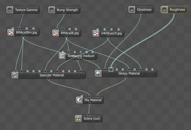

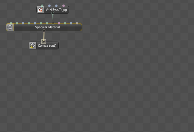

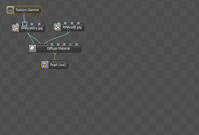

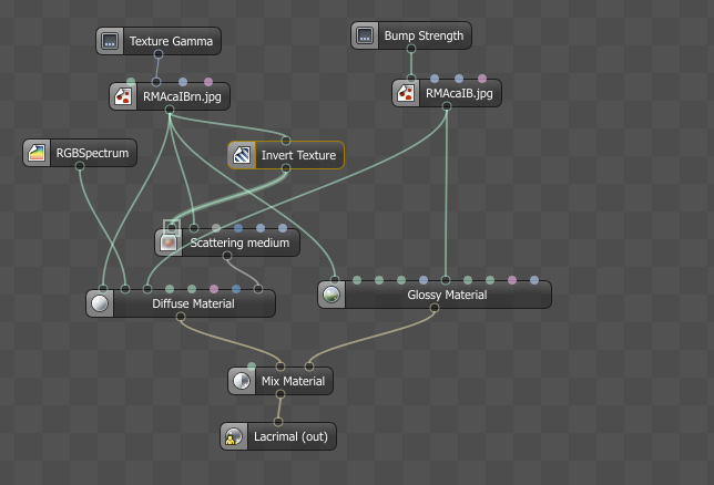

you're welcome ;) took me one or the other hour to find a usable setting, maybe not the best around, but it looks nice in most setups. still it is often needed to mix texture sets, because many of them use pupil textures with "included" reflections. of course this might conflict with "real world" reflections appearing on the eye, if a nice light setup is used. would be possible to edit them reflections out in photoshop, but of course it is easier to use a set without reflections. also there are a lot sets, which have some sort of shading applied, darkening the upper half of the sclera/pupil. these are also no good, because octane is (of course ;)) able to produce the shadows where they belong to be :) in the end i often use the v4 hi maps for all opacity slots, and also scleara bump & diffuse because they are very well balanced.
here are a few screens of an actual setup, to give you a little more idea about it...
lacrimal - to be honest, this is pure overkill; a simple glossy mat would be more than sufficient:
sclera - specular/sss-glossy mix mat. here it pays off to throw in a little complexity (most important part of the eye imo):
iris/pupil - a simple diffuse mat works best imo, glossy would also be ok; just depends on:
cornea - glass-like specular mat with the needed opacity map (standard m4/v4 is usually the best):

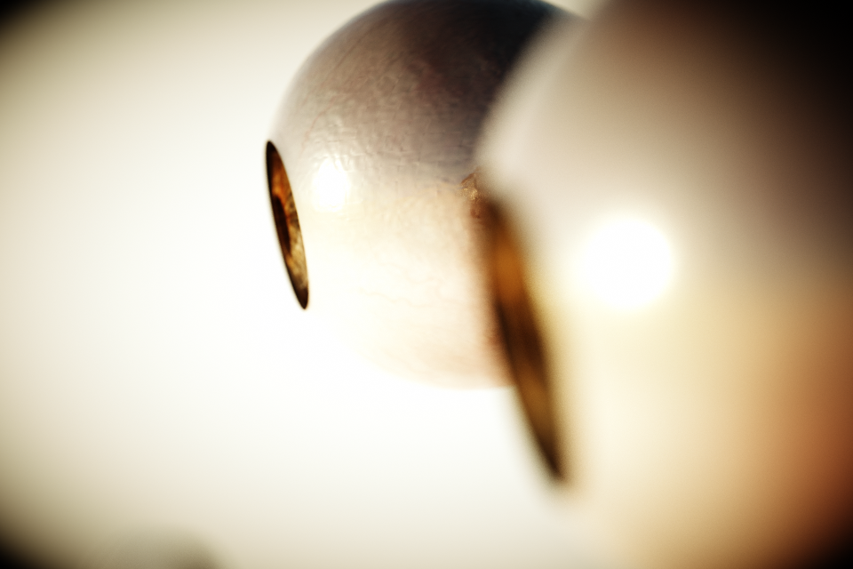

ps: one other word about the cornea opacity; i just found out :oops: that the opacity map i use on the cornea actually makes the cornea invisible. would be the same effect, if you add another off-portal to this part. the problem with the cornea is, that with m4/v4 eyes, the iris/pupil seems to be just a 2dimensional circular surface, directly connected to the cornea geometry; maybe it is just the uv-mapped bottom surface of the lens (haven't checked that yet. so if you apply a real specular material to the cornea, octane distorts or darkens the iris/pupil texture to an extent, it just becomes useless. somebody please prove me wrong ;)
example...
with specular cornea mat - the lens geometry is visible, but the pupil texture turns to something strange because of the refraction (even if ior is set to "1"):
without a cornea mat (portal set to "off" applied) - the lens geometry is of course gone, but the pupil/iris is clearly visible:

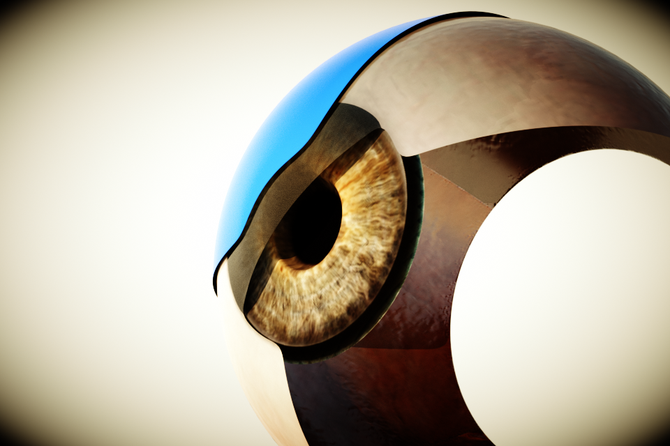

one more ;)
got it. the cornea is just a coplanar surface. and as it has no volume, octane will no way be able to calculate a correct refraction out of it. so whatever (specular) mat is applied to the cornea, it'll look wrong. note: in this example the pupil appears to be visible through the specular cornea mat, only because light can enter from the side (the blue part is the eye surface btw - another coplanar and therefore insufficient geometry for specular materials)...
all in all i'd say skip the cornea and use just another fake "null" material (portal set to "off"). not very elegant, but works ;)
