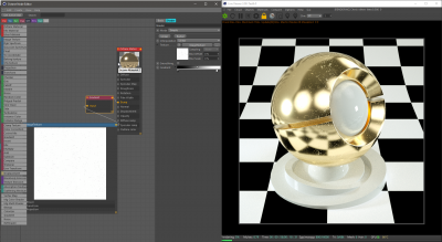

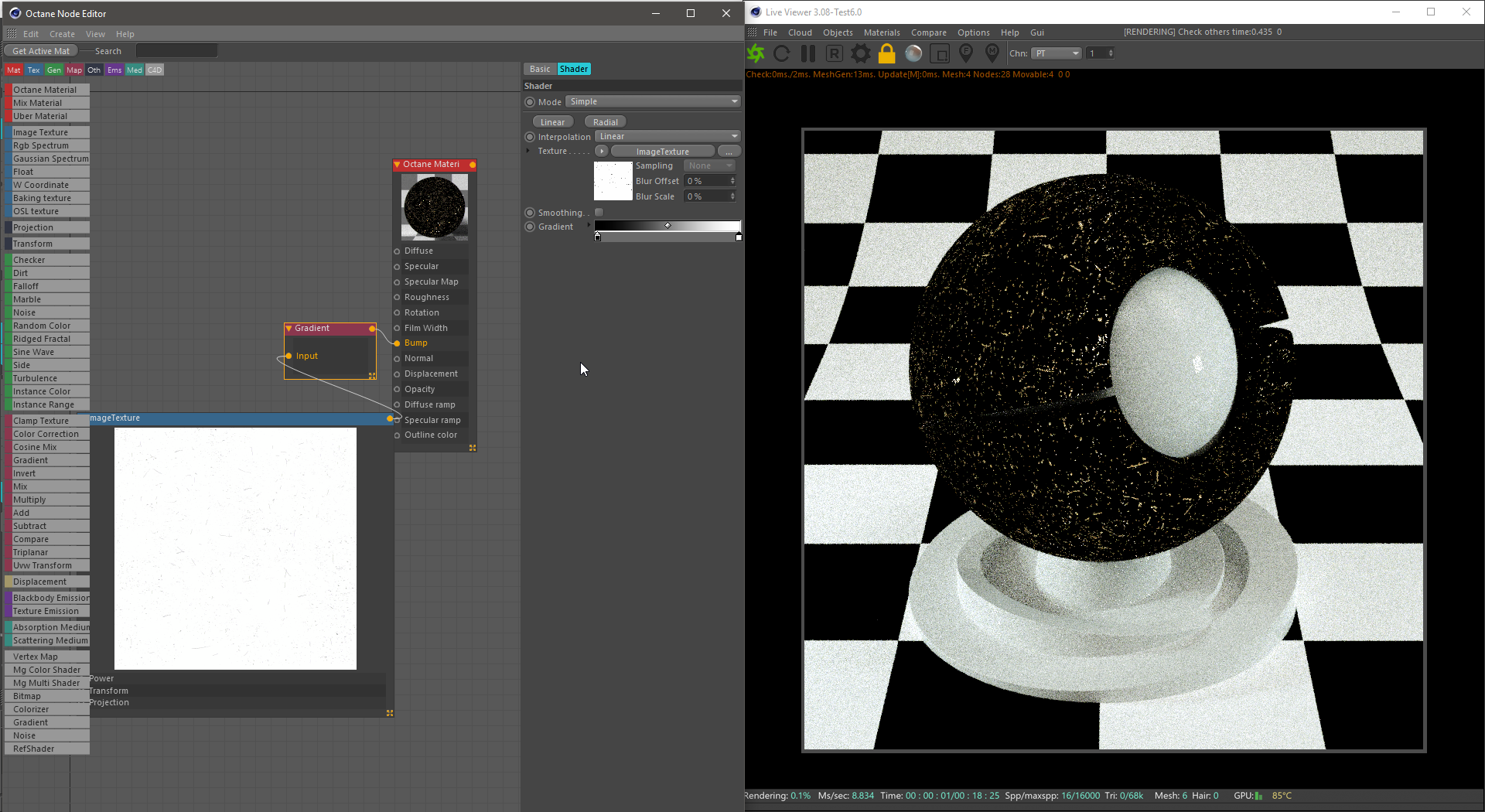

I have noticed an issue when plugging in a texture into a gradient node before it goes into bump. For some reason it makes all the white values of the bump map turn the material black:
I noticed that if I move the far right gradient node to the left a little bit it seems to correct the issue so it's not that big a deal but thought it worth reporting. For reference, my material should look like this (it's only an example - don't judge me ;) ):
