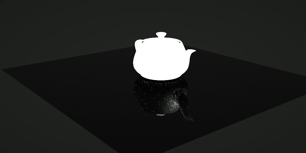

radiance wrote:Hi guys,
Can someone make me a decent bug report ?
I'll try.
I recorded a video
http://vimeo.com/14543219
password "pre23"
I thought it's something wrong with 3dsmax scene (I took it from evermotion dvd), but I tried to render very simple scene (just plane and teapot on it) and I got same result - no non-glossy reflections from emitter.
I attached archive with interior scene from video (11111.ocs and 11111.obj) and simple teapot scene (444.ocs and 444.obj)
scenes&objs.zip
scenes
(576.26 KiB) Downloaded 181 times

radiance
Posts: 7633
We've worked on this issue and it should be working with the new pre23_3 which was just posted today.
If the issue persists or is'nt %100, please let us know.
Thanks,
Radiance
