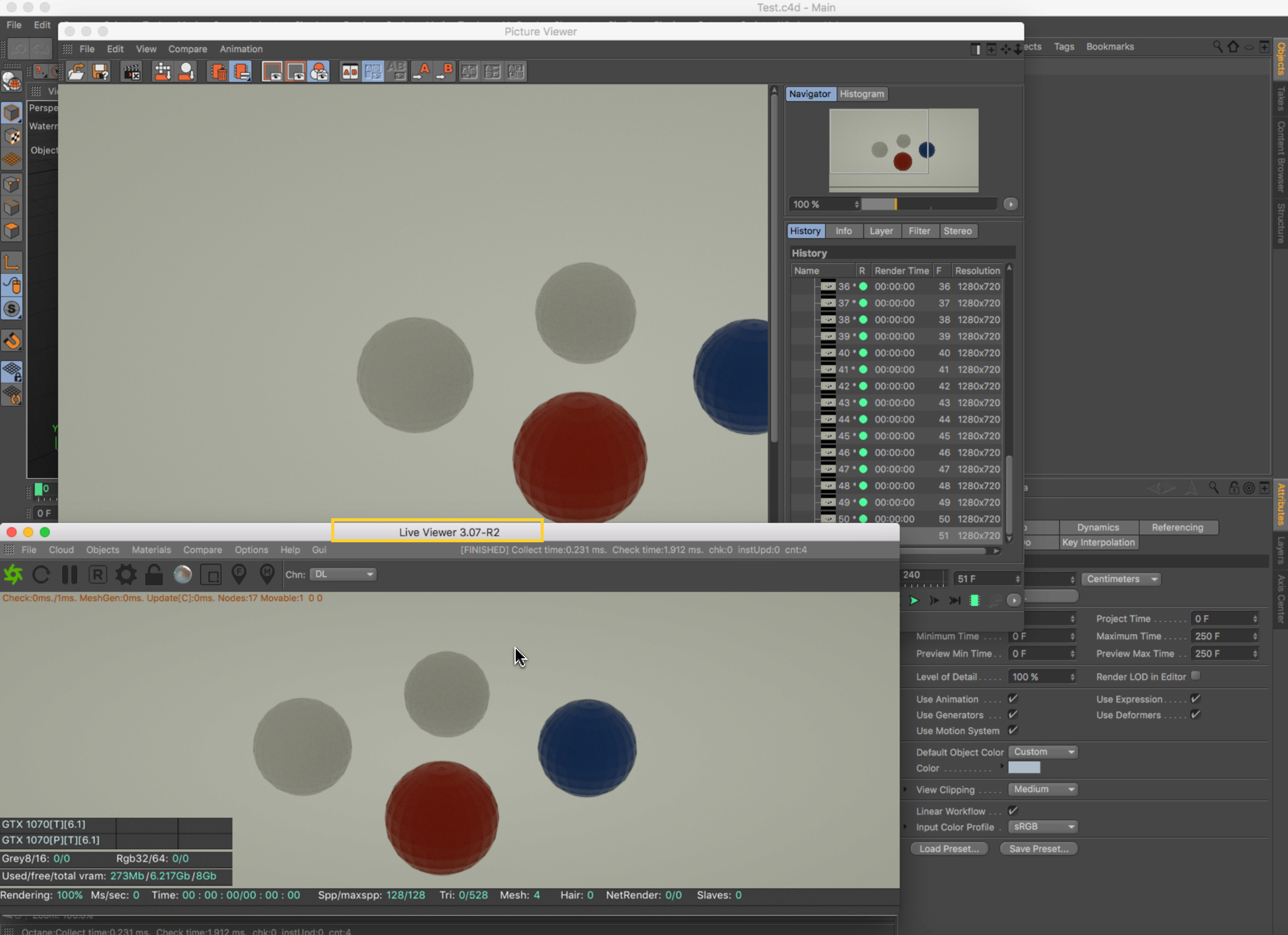

I have opened and rendered your scene as it was, but I have the same result in both LV and PV: Did you followed the instructions in the readme.txt file for a correct installation?

We cannot reproduce what you reported. Also it's interesting that you have a problem like this. Because randomcolors will work fine on render instances on every cases. Try it with "All movable" option in PV.
what is the PV? Where can i find "all movable"?
Picturw Viewer. You can find in octane render setting->geometry engine.divasoft wrote:what is the PV? Where can i find "all movable"?
