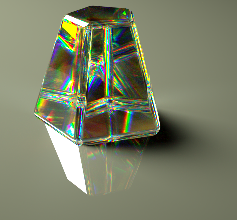

Hello,
i have attached two image files to demonstrate what my issue is. i am experimenting with dispersions and refrections of light in different glass objects.
to get the refractions and dispersions are not the problem, the problem is, that these rainbow-effect do not reflect on the ground.
i tried to make the ground diffuse or shiny oder glossy, but the dispersions do not reflect on the ground.
but that is exactly that, what i wan't to have :)
i hope, someone can help me to understand, why the rainbow-effect don't reflect on the ground.
* The two example images were created in Rhino with the Octane-Plug-In.
Kind Regards,
umix

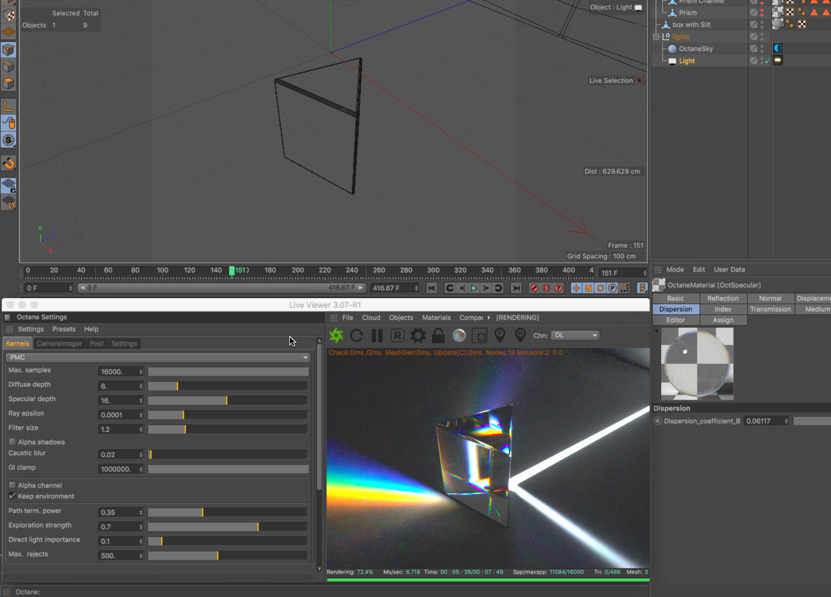

Hi umix,
you need a very strong and small light source, PMC kernel, for good caustics and dispersion.
Here is an example with c4doctane:
ciao beppe

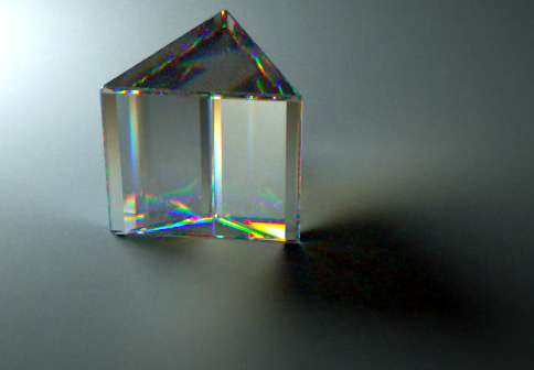

Too high dispersion -> the real life does NOT EXIST it...
But what's the specular material of prism? Glass?
If you want:
- glass prism - ior 1.509 and dispersion coefficient 0.006
or
- diamond prism - ior 2.379 and disp 0.011

Hi beppe and nuno,
many thanks for your answers. I think my problem is the lighting. beppe, can you please tell me with which lighting you created your very nice example? I think that's where my problem lies. Could you briefly describe to me which light you used and which settings you used?
In my example i used a rectangle polygon with a assigned diffuse material and blackbody-emission as scene-light. It seems, this is not the right way?
Thanks a lot and greetings,
ciao,
umix
Windows 10 * i7 6700 (32GB) * GTX 1070 (8GB)
Posts: 10621
Hi umix72,
the dimensions of the light have a great impact on the caustic/dispersion pattern, in my example the light was 100cm in height, but only 1cm wide.
As you can see in your example, the shadows are very blurry, so the emitter is too big for a good caustic/dispersion pattern.
ciao beppe
