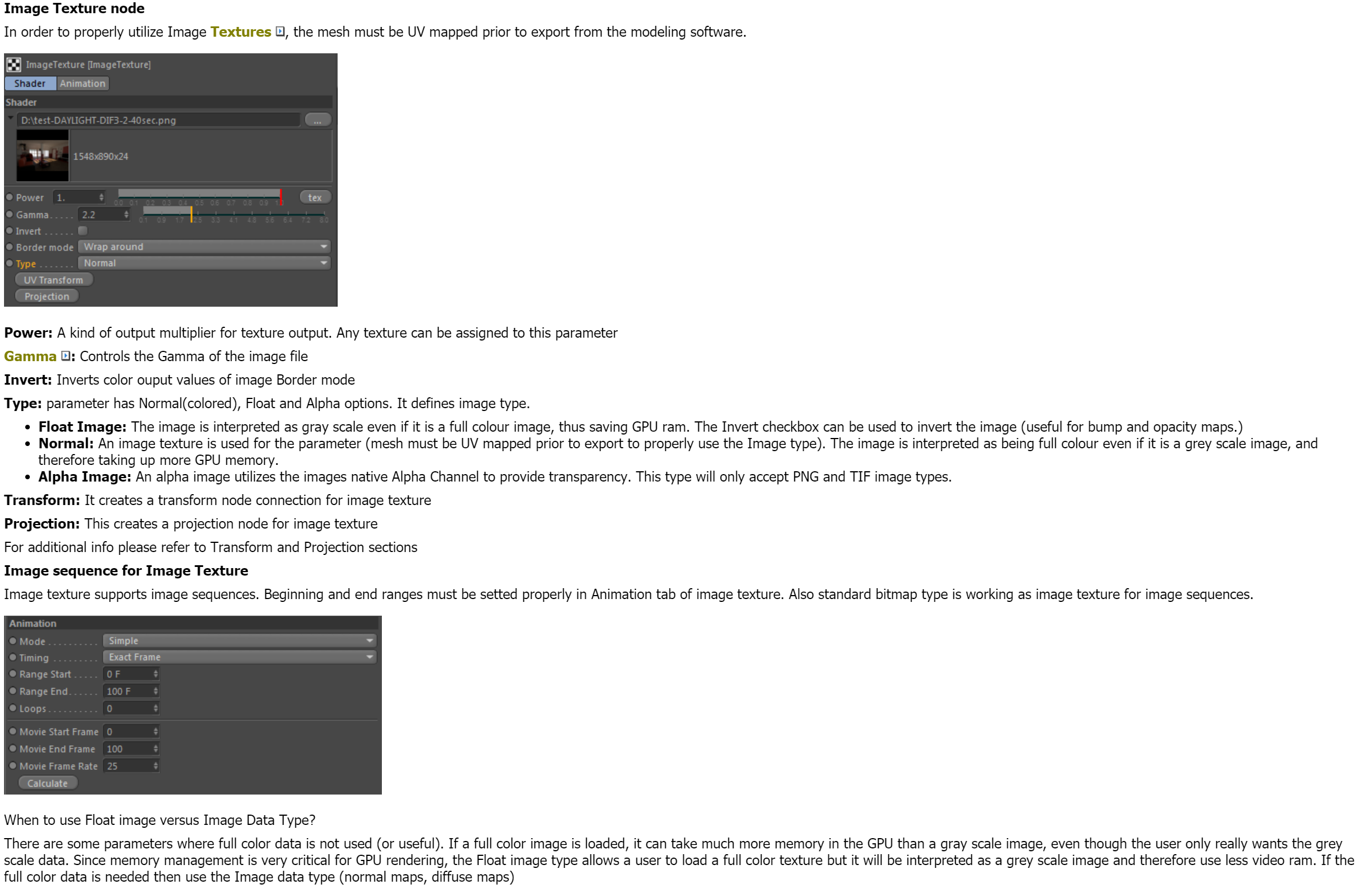

Here's the current description on this node:
