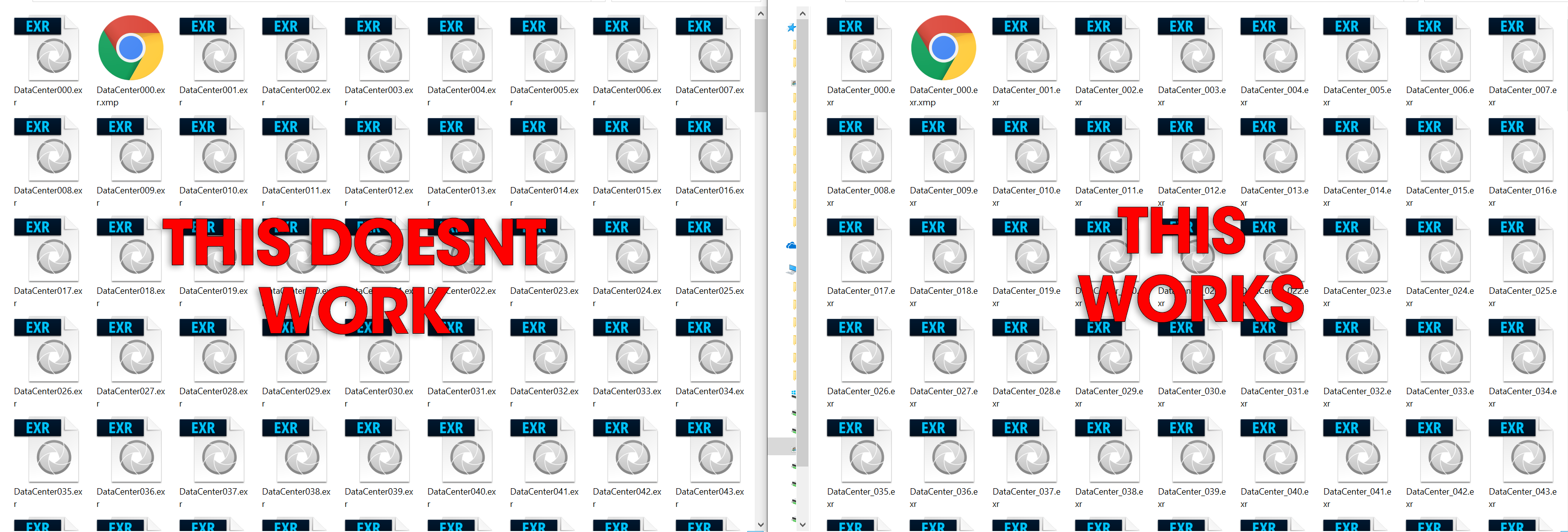

The file names definitely had an impact. This seems a bit un-intelligent of Octane to not be able to sort out a file name. However I was taking a .mov with a numeric filename (ex. 12345.mov) and making a frame sequence (ex. 12345000.jpg-12345....jpg). Octane is interpreting this filename and considering all numerics in the filename when calculating the frame range. No other software acts like this so it was a bit of a surprise. Now the only numerics in my file name are the frame numbers (ex. Movie_000.jpg - Movie_....jpg)

It's same as C4D does but sequence detection is custom code. So having double bunch of numberings that will cause wrong detection. What's your image names and range? Please post your scene.

However I have successfully and repeatedly loaded animation textures using EXRs in Range Mode with the correct numbers set. My filenames are Shot3_000001.exr - Shot3_000281.exr. This seems to work ok, but I still can't slip the shot in the node.

Do you have to use an underscore before the sequence name?
