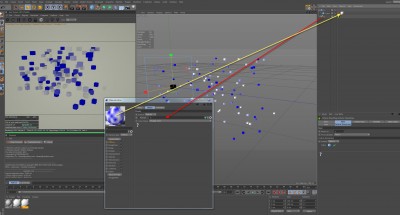

try with render instances for generators or go another way like i did in picture.JavierVerdugo wrote:Of course I did...There's a sample scene in first page. Have you checked it?
My apologizes, I upload 1 zip with 2 project files. One for the XpTrails, second for the XpGenerator.Why don't you post a sample scene to figure what you do?
You can see in both projects that there are 2 emitters. Emitter A with Single color display, and emitter B with random color displays.
In both cases, xptrail and xpgenerator display correctly the color of the xptrails and xpgenerators for the emitter A. But for the emitter B, I assume they get the color from the first INDEX particle data. In this case this particle is red so they are all red.
Cheers
