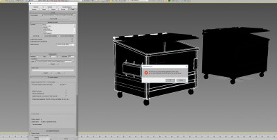

Hi seems like 2015 max crashes when we are trying to convert the materials of the file attached thank you

Hi coilbook,
Your issue is caused by missing mental ray legacy assets.
Remove them before converting your scene.

I also get crashes with convertion of models from time to time. Mostly releated to VRay composite materials as it seems. I have to untick the baking feature of unsupported materials to mak it work and re-built all materials manually.
Not best way but I understand an converter can't consider all kind of material combinations.

Hi mbetke,
Do your crashes happen if .psd textures are in vray composite or other slots?

I didnt noticed or investigated. I will check next time the issue happend and report back.
