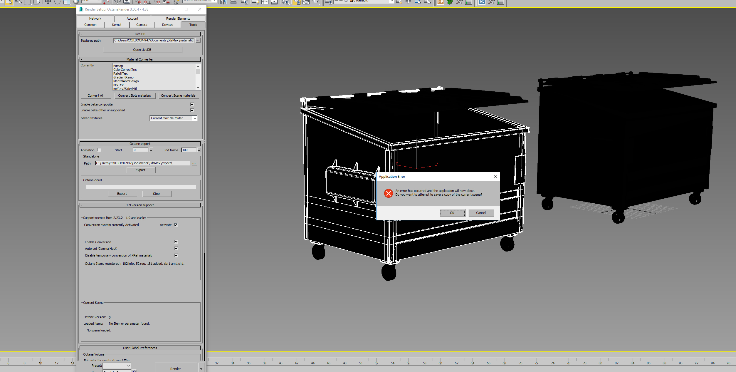

Hi seems like 2015 max crashes when we are trying to convert the materials of the file attached thank you
dumpster_max.rar
(33.35 MiB) Downloaded 329 times
paride4331
Posts: 3979
Hi coilbook,
Your issue is caused by missing mental ray legacy assets.
Remove them before converting your scene.
Regards
Paride
