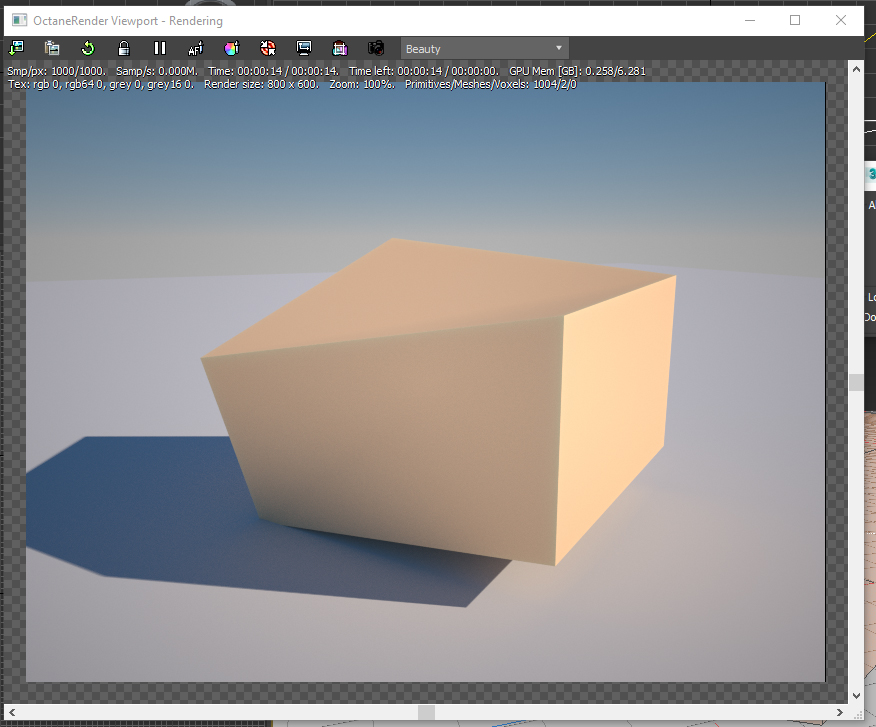

Hi Fabrice,
you have to set density in scattering node.
Here un basic sss material made with diffuse material.
Regards
Paride

I'm still playing with density but it has allmost no effects.
From 1 to 150 I barely see no changes...
The light should be massively changing to the corner because of the thickness varying...
PS : And another topic, how to make slight reflection on that ?
