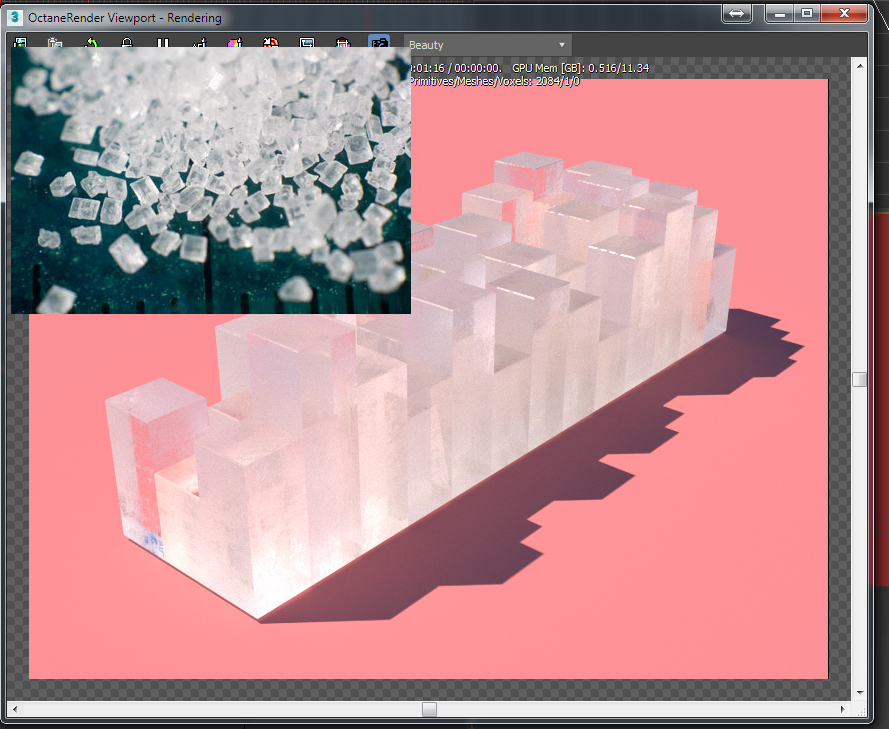

Hi Fabrice,
with sss materials you have to use scattering or absorption nodes.
Attached a 3dsmax sss examples with materials made of diffuse or specular material.
Regards
Paride
Regards
Paride

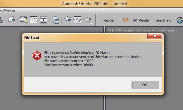

Hi Fabrice,
Here it is
Regards
Paride
Here it is
Regards
Paride
- Attachments
- sss-2014.rar
- (80.51 KiB) Downloaded 252 times
- paride4331
- Posts: 4004
Hi Fabrice,
this should work
Regards
Paride
this should work
Regards
Paride
- Attachments
- sss-2014.rar
- (92.72 KiB) Downloaded 244 times

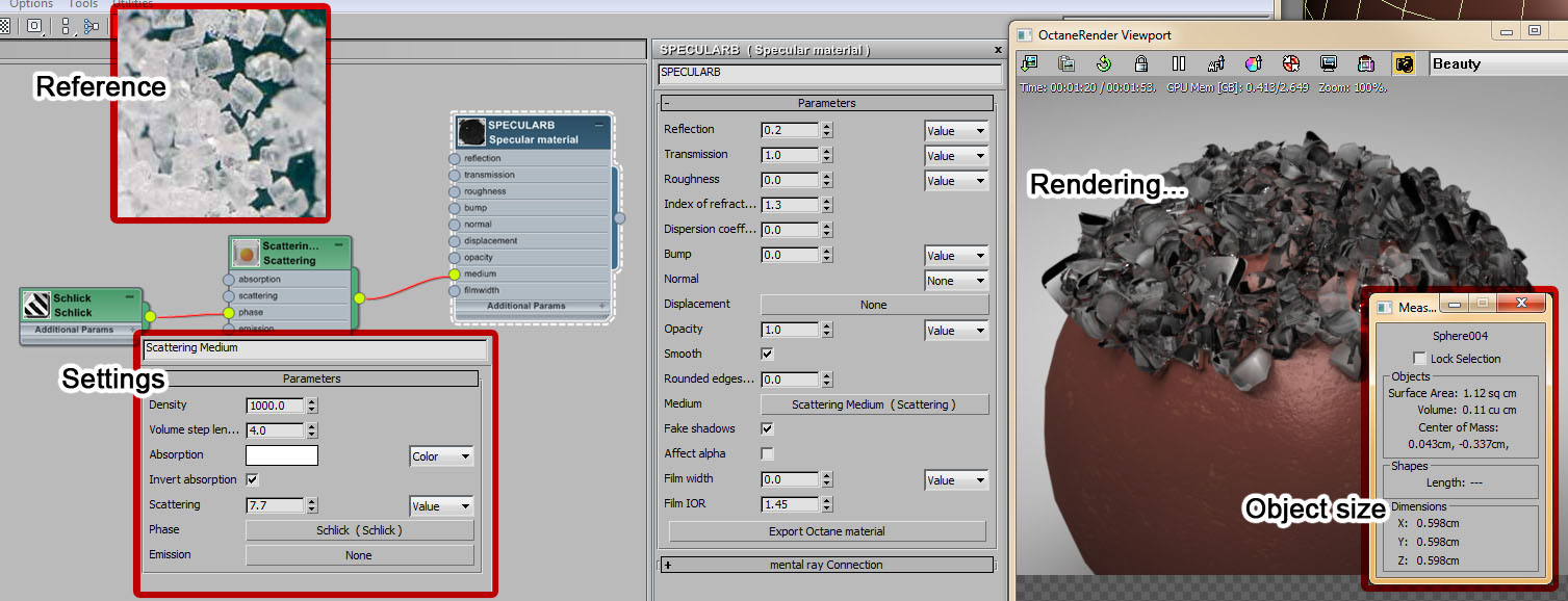

Hi Paride,
still struggling with SSS...
I'd like to create some crystal sugar (on op of a chocolate sphere).
I succeeded having some nice SSS effect (thanks to your help) on the little particle pieces
but still have a big problem :
there's allways some black spot in my renderings.
And I cant get rid of this overall black tint...while the sugar should be globally white).
Maybe it's related to the very small size of the object?
(chocolate sphere is less than 1cm (o,3 inche))
Any advice?

Hi Fabrice,
I think it depends on using white rgb color in the enviroment slot.
Try using different light sources.
Regards
Paride
Regards
Paride

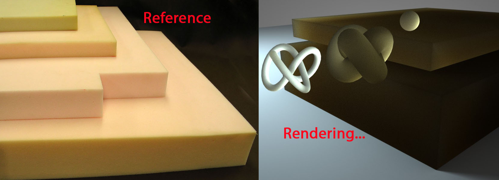

I'm trying now how to make a foam material (as in the references uploaded).
But I still cant figure out how to set up sss.
The color is dull and too dark, the light is weird...and render is awfull.
It look like bad wax or soap but absolutly not foam.
(I started from a sss specular material Paride sent me)
I'm lost with sss...
Any help ?
