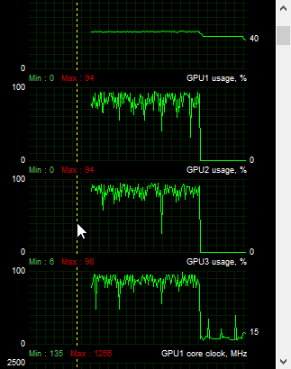

I have 3x 980ti cards running in my workstation. While rendering i noticed that all of them have a very unregulary gpu usage. (see image)
i have "use priority" unchecked for all cards . What could be the reason and how can i fix it?
Cooling is also not the issue, I have two hybrid cards and the temps stay between 60-70°. We have a second Workstation aslo with 3x 980tis and they run smoth at 100%.

Try maximum values for parallel samples and the one below that. Path tracing node.

BorisGoreta wrote:Try maximum values for parallel samples and the one below that.
+1. :) But at PMC kernel - not full GPU usage in v3.0x but yes full GPU usage in v2.26.1 or older version. ;)

Parallel samples and max tile are available in path tracing kernel and in direct kernel too, see attached image.
