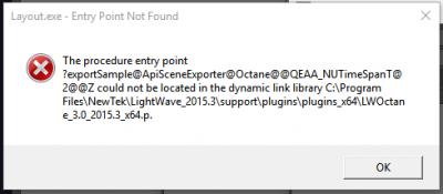

This problem is usually related to mixing old Octane.dll/Octane.dat files with a new plugin version. Be aware that now you don't need to copy any file to the LightWave/bin folder to install the plugin, so check your LightWave/bin folder to see if you have any older Octane.* file inside and remove them.

Well, if Standalone doesn't work, then the problem can be related to your computer. Perhaps you need to install the latest drivers. What GPUs are you using?
Also, if it is a new computer, to install the plugin you should try to install before the VisualC++ 2012 redistributable package:
https://www.microsoft.com/en-US/downloa ... x?id=30679
Thanks,
-Juanjo
