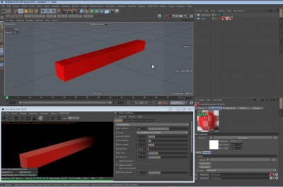

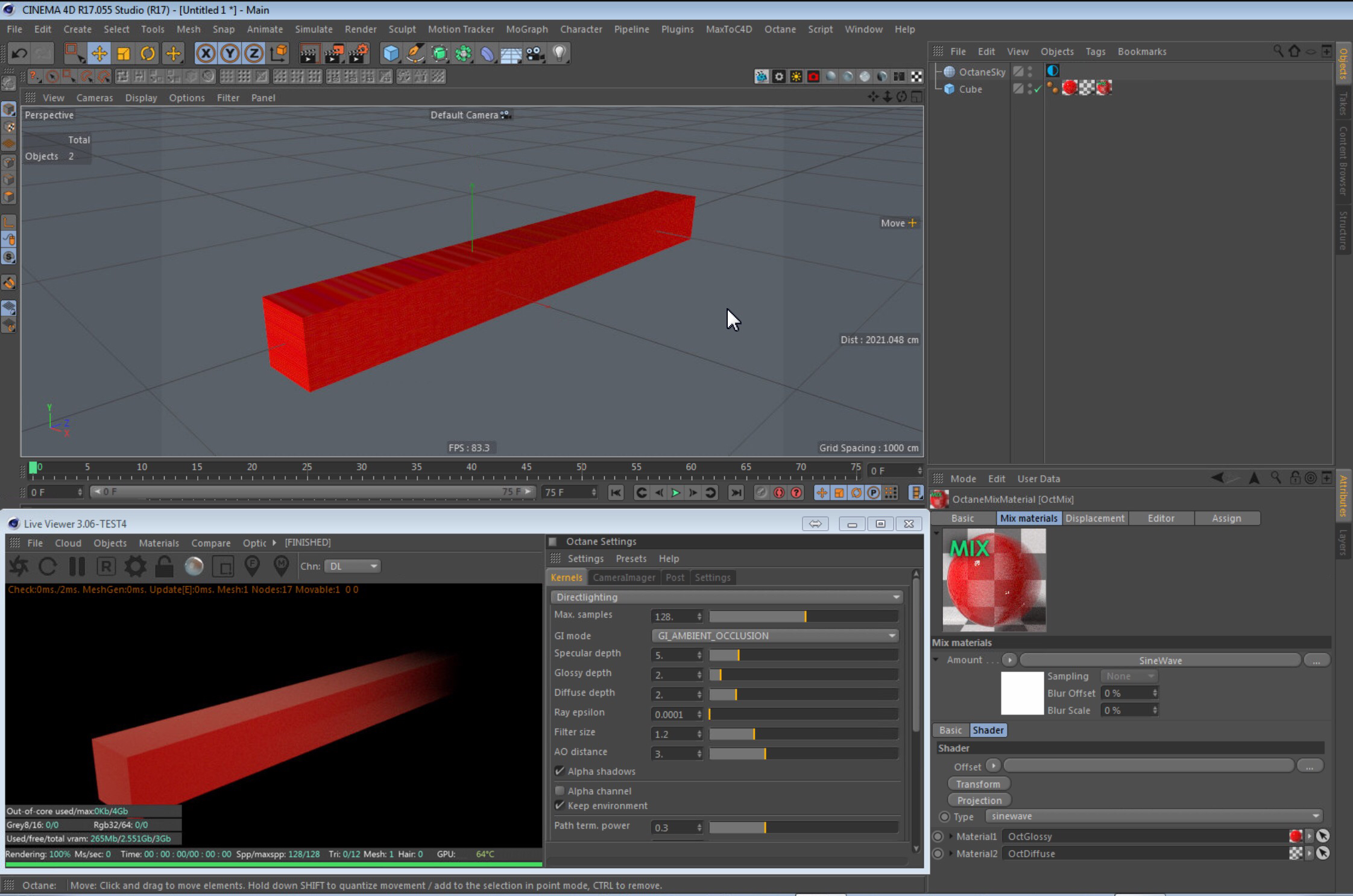

Hi dgdunne,
here are some ideas:
1. use the Z-depth pass to fade the far geometry with black background in post, note that the Z-depth value is in meters, and you can input the exact distance.
2. if far geometry has only one material, you can mix it with a diffuse 0 opacity, and a sineWave node in amount.
3. if you have multiple materials, you could try with this particular technique mixed with the second solution:
viewtopic.php?f=30&t=59185&p=303108&hil ... ir#p303108
