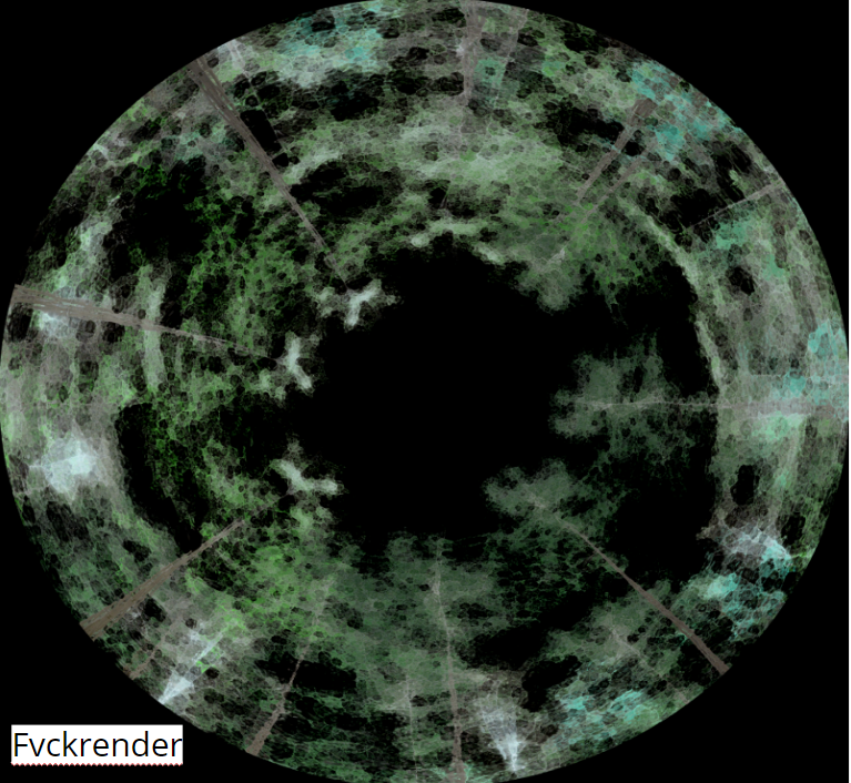

Hey thanks that what i taught but its not working it has to come out like this

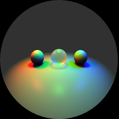

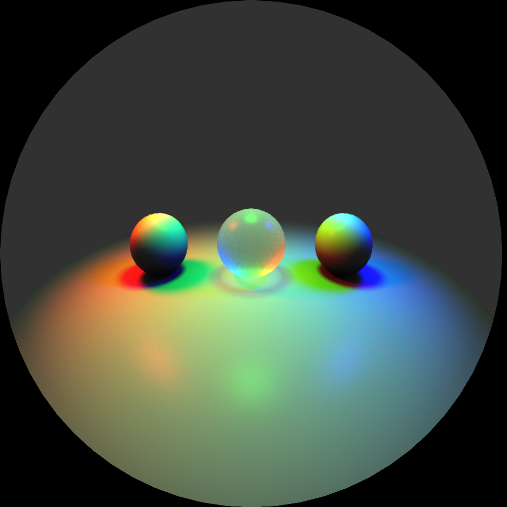

Regular Octane pano camera will not generate those black edges. At the moment you may achieve this effect using the baking camera Revert baking pin, which will use arbitrary geometry as a lens. You can use a half sphere and generate something like:
I am attaching a sample project as a way of example.
baking_camera_fisheye.orbx
(221.34 KiB) Downloaded 253 times
Whether there's a better way to do this on C4D I am unaware, but I though this would be good for future reference as well.
