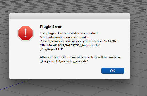

I keep receiving an error message suggesting that " The plugin liboctane.dylib has crashed" each time I try and open octane's live viewer window in C4D. I've tried opening with a simple default primitive model to make sure it wasn't a 3D model issue, but it still crashes and send me the error. Can anyone help me?
Plugin Error

I can render material previews in the standalone version. As far as hardware goes, I've been a doing projects using Octane with my current hardware set up for a few months. When I did a fresh install of my macOS system a few days ago, I began to get errors alerts from Octane. I've attached the bugreport.txt file as well as a screen capture of the message I receive.

Same plugin and different OS. I have no experience with Sierra. Here only thing i can see that's a crash on environment codes. My suspect is your OS and drivers.

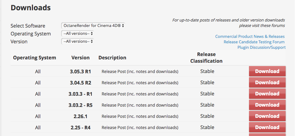

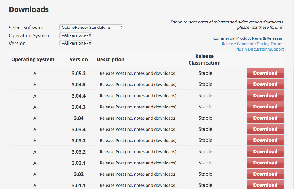

No, I haven't checked 3.06-test 3. The latest I have access to in the download section is 3.05.3 (R1) and 3.05.3 (Standalone version).aoktar wrote:It's not a solution. Have you checked 3.06-test3?Kham.lewis wrote:I'm back. So, apparently Octane for vC4D 3.04.5-R2 and the Octane standalone V3.04.5 work much better. I suspect that the latest version of macOS Sierra, my graphics card CUDA version and the latest version of Octane play nicely on my machine.
