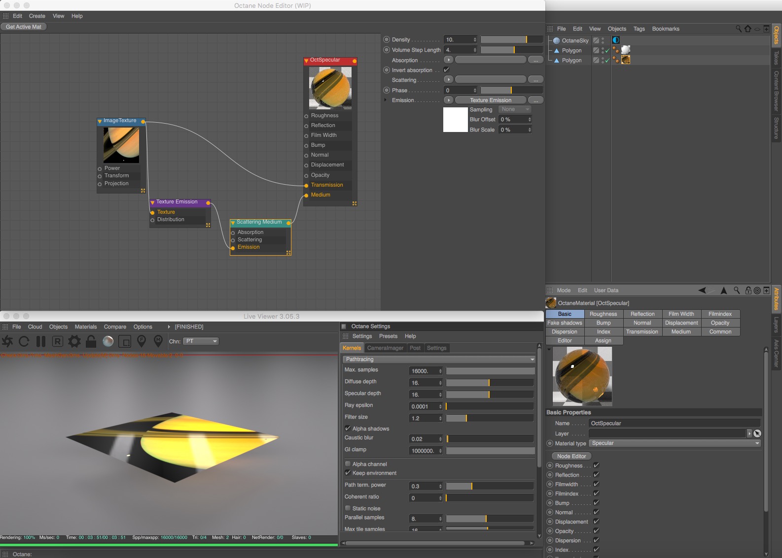

Posts: 10514
it's not a workaround, is more how the octane shaders currently work.
If you don't want to use a mix material, you can use a specular material with an sss medium node with emission active for simulating a glossy emitter ;)

Sorry to resurrect this old thread, but I'm trying to achieve the same thing. I can't work out how to add SSS though a specular material like it says above? Please could somebody help?
I'm basically trying to create an iPad screen which has a bit of reflection - must be a common thing. I don't really want to emit through a sheet of glass if I can help it :)

Posts: 10514
Hi Tom,
since it is roughly an emissive plane, have you tried by mixing a diffuse material with emission and a glossy for reflections?
