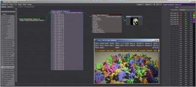

I need help with Octane materials ! I use LW instancing for populate with grass and i want to apply general variation color on my grass ground ! How can i do please ?

You can use the RandomColor node to get a random gray value between 0 and 1 for each instance and link this node to a gradient node to configure the color variations.

Pehaps an example please ?

This is the idea. You can also use the output of the gradient node to multiply or mix textures or colors.

Thanks Juanjo ! Much appreciated !
