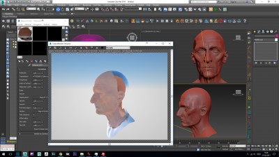

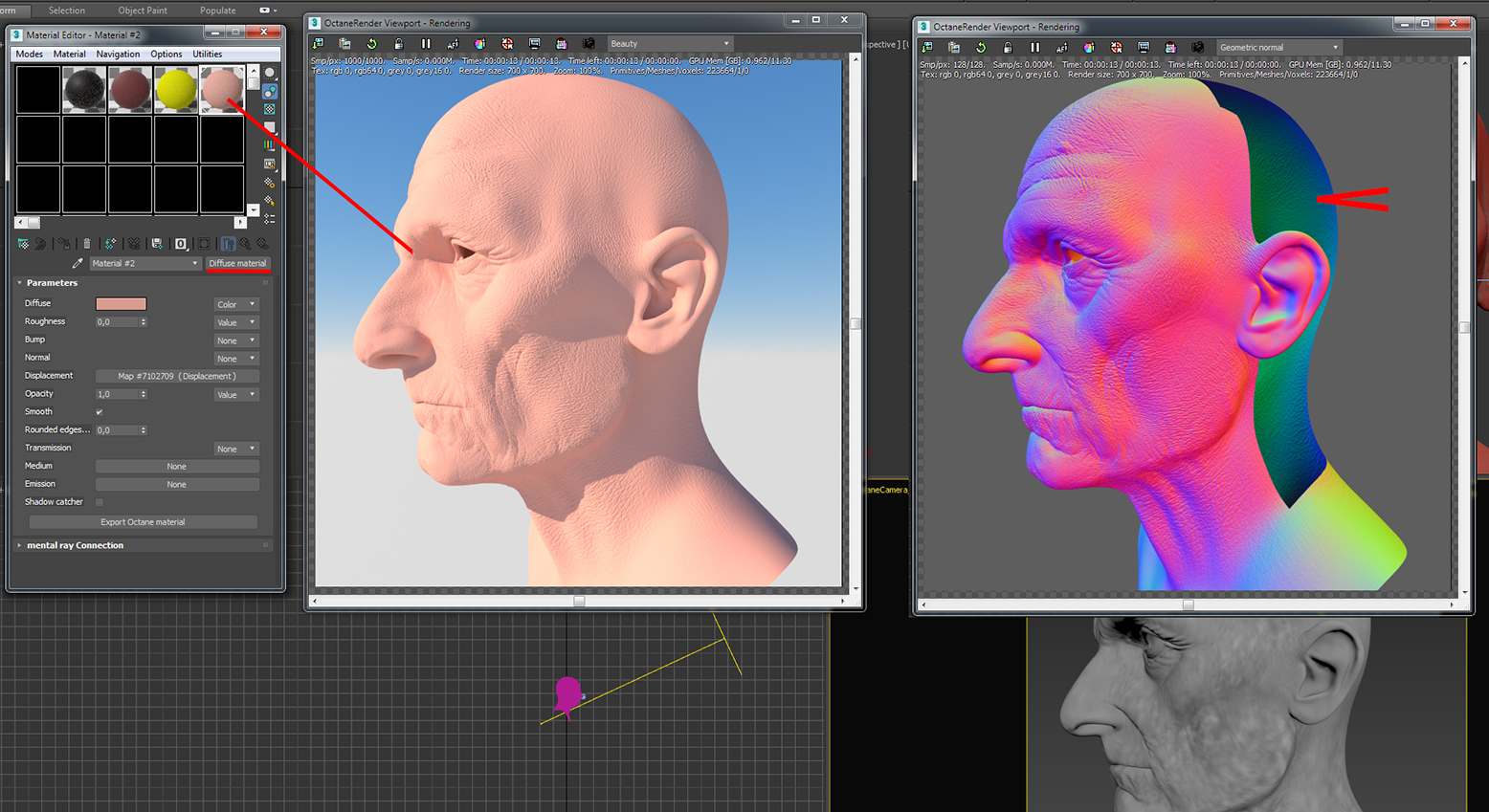

Hello,
i have a strange probleme when i put a displacement map on this object with specular mat.
the back head become transparent.
it doesnt append with a glossy or standard mat.
Any idea please ?

- visionmaster2
- Posts: 107
- Joined: Wed Apr 10, 2013 12:52 pm
Thank you Paride4331 but it doesnt work .
Last edited by visionmaster2 on Tue Feb 28, 2017 12:08 am, edited 1 time in total.
- visionmaster2
- Posts: 107
Hello,
i deleted the uvs in zbrush.
then uvmaster and reexport the obj and maps.
everithing works now.
i really dont understand why it bug with a specular map.
Thank you Parride4331
