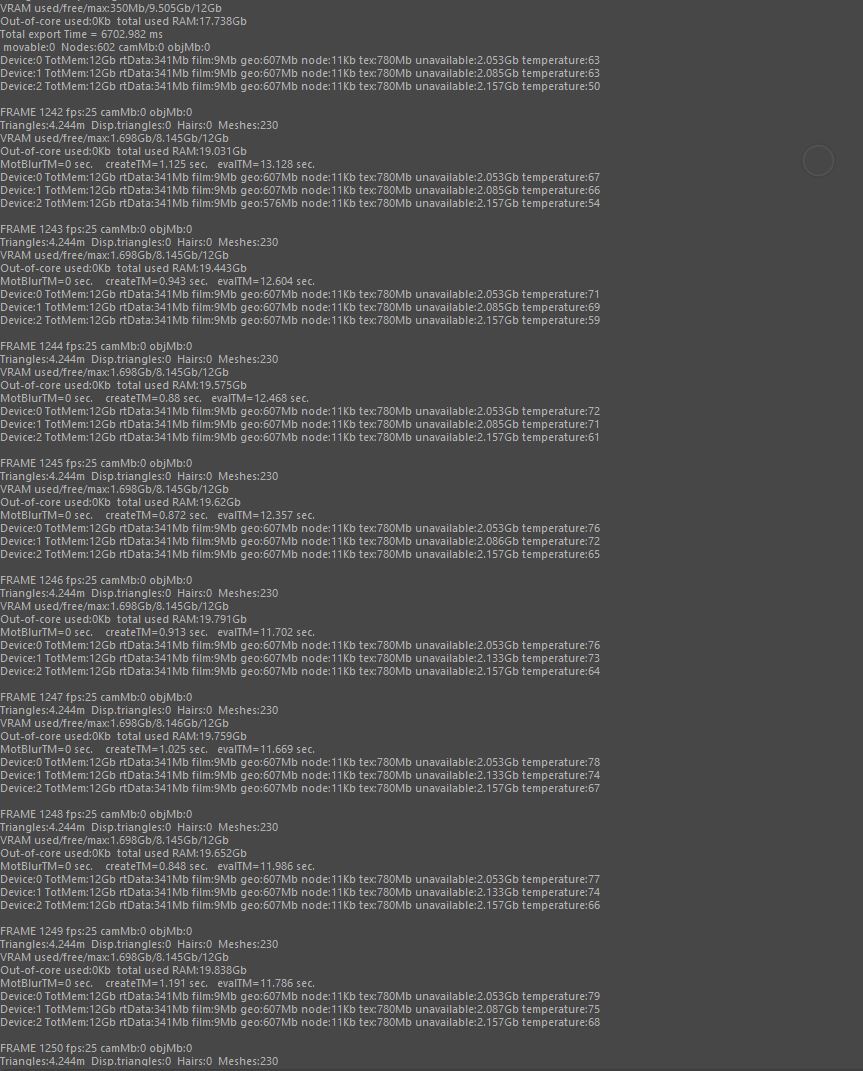

this is the end frame time and console
punchin
Posts: 16
Joined: Fri Apr 22, 2016 2:51 pm
and this is the console at the 1st frame..... the frame time slowly increases with every frame?
This is just a short example . it starts at 30 secs per frame and ends at 43 secs per fraame . but if I let it run over night I would have frames from 2 to 3 mins for the same renderings.

Sorry I have an update... all the machines have increasing render times. I ca'nt see any difference in the stats between the 1st and last frame.. Is there some sort of caching of the characters animation going on that increases the calculations over time?

punchin wrote:Sorry I have an update... all the machines have increasing render times. I ca'nt see any difference in the stats between the 1st and last frame.. Is there some sort of caching of the characters animation going on that increases the calculations over time?
I can't estimate by this output. Is it possible to share a scene with me? So i can exactly say the reason after investigating.
