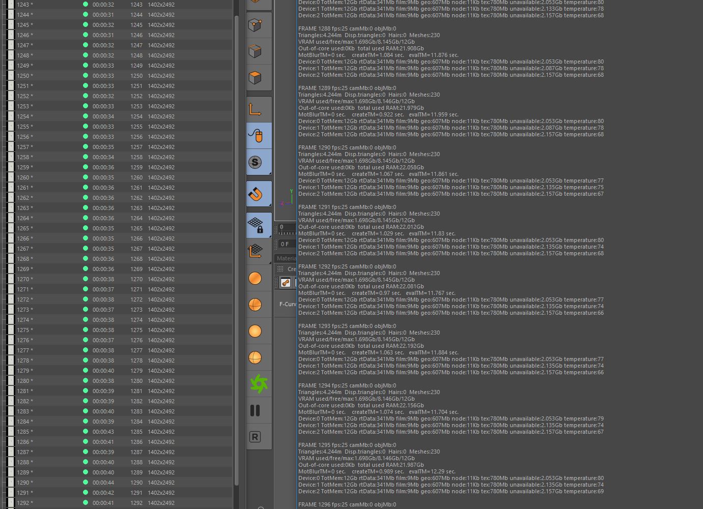

Can you open Console windows and send the what you see from statistics from nr.2 and nr.3?
Sorry I have an update... all the machines have increasing render times. I ca'nt see any difference in the stats between the 1st and last frame.. Is there some sort of caching of the characters animation going on that increases the calculations over time?
I can't estimate by this output. Is it possible to share a scene with me? So i can exactly say the reason after investigating.punchin wrote:Sorry I have an update... all the machines have increasing render times. I ca'nt see any difference in the stats between the 1st and last frame.. Is there some sort of caching of the characters animation going on that increases the calculations over time?
