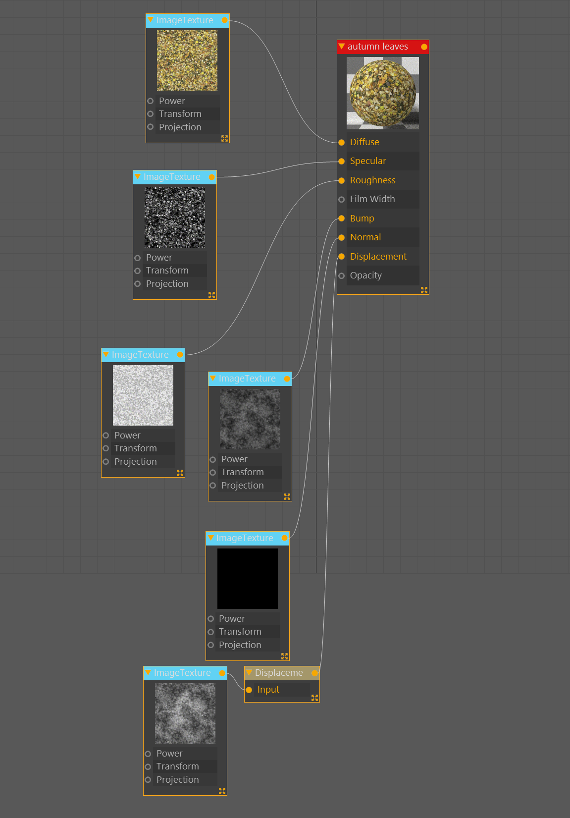

I think you created an octane material and plug only a diffuse material from your quixel texture pack.
you have to plug a diffuse map + a normal map + a roughness map + a bump map and a displacement node with an image texture node linked to it.
I will make a screenshoot for you asap.

Thank's for your information and waiting your screen copy or file to know how do that

Hi bros, this is Chris, the developer of RD-Textures.bertritude wrote:Hi guys,
I discovered megascan yesterday and I wonder if there's a way in octane (script or other way) to create quickly and easily new material with the maps exported with megascan. (like quixel MDB).
Thanks !
Bertrand
Why not using RDT ??
All materials are already setup correctly for octane and they are ready to use.
I mean, I'm octane-user and I created this stuff (in the first days) for myselfe.
(((( I can tell you why: damn MARKETING !"! ))))
Please give it a test and try out my freebies at: https://www.rd-textures.com/shop/
You will see, there are c4d-files included.
If you need any further help, don't hesitat to send me a mail to: [email protected]
There are some cool tricks in conjunction with my materials to make them useful on large areas and right now I uploaded a tutorial to show how to paint RDT in cinema4d-bodypaint
Tut-Link: https://youtu.be/TN4An0gUfXo
