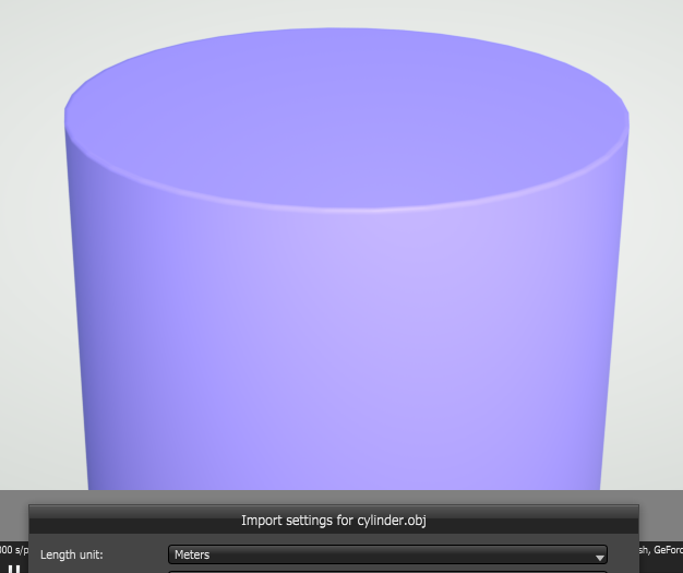

Ok I got it !
the difference has nothing to do with difference between Maya and Modo geometry.
This is a scale issue.
Here Octane gives me a perfect round edge for this cylinder imported as meter:
cylinderMeter.orbx
(65.69 KiB) Downloaded 279 times

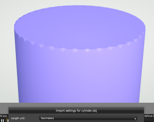

But if in the same scene with the exact same cylinder, I modify the scale import setting to decimeters, I have these artifacts.
cylinderDeciMeter.orbx
(65.7 KiB) Downloaded 277 times
So indeed there's still an issue depending of the scale of the scene, I admit I had only tested big scale scene.

This seems to have been happening for a while now but you have been the first ones to report. We are adding this to our backlog to fix ASAP.
@calus
Thanks for your feedback, I have detected the bug so it will be fixed in the next build.
