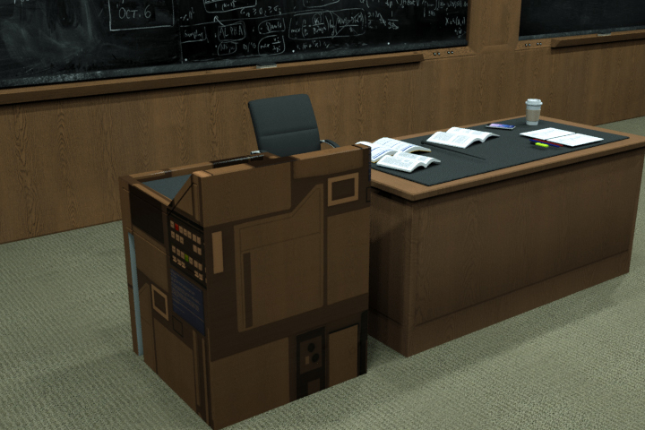

It may not be the UV then, but it certainly has the same effect. I'm attaching an image to show what I'm talking about.
This is the effect I'm referring to as the UV map having been changed.

Am I misunderstanding something here? There is nothing strange about the content I'm working with. At the start, in Daz Studio, all of the UV maps are right. The image maps line up with the UV mapping correctly. There are a lot of wooden surfaces. Each surface has a different UV map and a different image and the images and UV maps line up. I want to change the settings so that it looks like wood rather than concrete with a picture of wood spray painted on it. I want to keep the UV mapping, the image maps and the material names but replace the settings so that it looks like wood. This is a very simple task and shouldn't be very difficult and shouldn't require editing each material one at a time setting by setting. This is also one of the most common tasks that I need to do.
The scene I'm showing is the same as almost any other scene out there from anyone. There are various surfaces that have various UV maps. Each surface has the correct UV map for the surface, but each surface has a different UV map and different image maps. This is going to be the same with pretty much anything, including the stuff that I make myself (though what I'm showing here wasn't made by me). Obviously what I'd like to do is to just copy the setting so that it doesn't in effect rename the material to "copy of wood shader", "copy of wood shader (1)", "copy of wood shader (2)" etc. This, as I see it, is a design flaw of the octane plugin. The bigger issue is that, if I understand correctly, the template that you make has to be designed for the particular UV map for which it will be used? If so, then there is no point in trying to use Octane. I think the problem is that I don't see a way to copy just the settings without changing the image maps. Instead, the only way to keep the image maps is to completely replace the shader which causes such an amount of problems that it's simply not an option. Thus, templates are pointless except for in very specific odd situations such as doing the shader for a standard character type (ex: Genesis 3).
If you look at something like the Reality plugin, it has a VERY simple way of dealing with this. When you apply a new shader, it doesn't redo the UV mapping. The UV mapping stays the same before and after applying any shader so if you apply a new shader (ANY new shader) and keep the old image maps they will still line up if they lined up before you changed the shader. Also, in Reality, it doesn't replace the old shader and then move it somewhere and change the name of the new shader to "copy of " and all that. It simply lets you keep the name of the material the same as it was. I was able to change materials very quickly and easily. With the setup you have here, it seems like everything takes as much time as humanly possible because at every step of the way the plugin seems to have strange ideas about what you're trying to do that I can't understand. I don't understand why it changes the name of the material. I don't understand why it wants to change the UV mapping, especially when I'm using a template. I don't understand what this thing is attempting to do. I've worked with Maya. I've worked with Daz Studio. I've done my own UV mapping for some pretty complex objects. I have never seen anything like this before.
It seems to be designed with the idea in mind that you either want to change settings for each material one by one, or you want to completely replace the shader image maps, UVs and all. I want to change the shader settings but not the image maps. You might think that a template would do that, and the template does keep the image map, but since it changes the UV mapping there is no reason why templates exist unless you have lots of objects with EXACTLY the same UV mapping. It hinders that feature to the point of being basically pointless.

You are confusing some terms, quite a bit, actually. A UV map is how an image aligns along the polygons making up a surface, to change it, you have to create an entirely new one in a modelling program (i.e. Maya or Blender). Daz Studio and the Octane plugin do not do this. An image map not aligned to that UV will display oddly, because the image does not align with that UV (this is the situation you keep referring to as changing the UV, which is incorrect. You are changing the image map to a map not aligned with the unchanged UV). If you set up a template material correctly, it is using the settings of the material while replacing the image maps (which are aligned to the UV correctly). That is the entire point of the templating system. If your templates are changing the maps to something not intended, they are not set up correctly for what you want, as I stated. The renaming is an internal function, and incredibly easy to fix, as you pointed out. If that particularly bothers you, I have no good solution for that, so I'll leave that up to Face_off, should he choose to address it. When I get home, I will go ahead and write up a step by step guide to setting up a template for a few alternate scenarios, and maybe that will clear up some confusion over them, but it will be a few hours at least, unfortunately. I'm assuming how I present the information is somehow lacking without images to reference, so hopefully that will help clarify things a bit, with an unfortunate delay, unless someone else gets around to it in the meantime.

Ok, I cracked it. It had nothing to do with the image maps. It had nothing to do with the template. All of that was fine. What was causing the problem was a 2D Transformation node feeding into the UV Transformation input on the image mage. The image map it's self was fine, but it was being modified by a 2D transformation node. I stand by what I said about there being a lot of things about the plugin that are very user unfriendly, but I think I can make it work. I may make a post at some point just pointing out all of the ways I think the plugin could be edited to make it far more user friendly.

Regarding the UV mapping - I'm still unclear on what the issue was. It's not a problem that has been reported by other users. If you send me a sample scene which illustrates the issue I can take a closer look.
