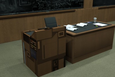

It may not be the UV then, but it certainly has the same effect. I'm attaching an image to show what I'm talking about.

Am I misunderstanding something here? There is nothing strange about the content I'm working with. At the start, in Daz Studio, all of the UV maps are right. The image maps line up with the UV mapping correctly. There are a lot of wooden surfaces. Each surface has a different UV map and a different image and the images and UV maps line up. I want to change the settings so that it looks like wood rather than concrete with a picture of wood spray painted on it. I want to keep the UV mapping, the image maps and the material names but replace the settings so that it looks like wood. This is a very simple task and shouldn't be very difficult and shouldn't require editing each material one at a time setting by setting. This is also one of the most common tasks that I need to do.
The scene I'm showing is the same as almost any other scene out there from anyone. There are various surfaces that have various UV maps. Each surface has the correct UV map for the surface, but each surface has a different UV map and different image maps. This is going to be the same with pretty much anything, including the stuff that I make myself (though what I'm showing here wasn't made by me). Obviously what I'd like to do is to just copy the setting so that it doesn't in effect rename the material to "copy of wood shader", "copy of wood shader (1)", "copy of wood shader (2)" etc. This, as I see it, is a design flaw of the octane plugin. The bigger issue is that, if I understand correctly, the template that you make has to be designed for the particular UV map for which it will be used? If so, then there is no point in trying to use Octane. I think the problem is that I don't see a way to copy just the settings without changing the image maps. Instead, the only way to keep the image maps is to completely replace the shader which causes such an amount of problems that it's simply not an option. Thus, templates are pointless except for in very specific odd situations such as doing the shader for a standard character type (ex: Genesis 3).

I have the correct image maps. The image map hasn't changed. I used to have the right base image map but some of the other image maps wrong. Now I have fixed that issue but I'm still experiencing the same issue. I'm not sure what's going on. I will try and find out what's going on.

Ok, I cracked it. It had nothing to do with the image maps. It had nothing to do with the template. All of that was fine. What was causing the problem was a 2D Transformation node feeding into the UV Transformation input on the image mage. The image map it's self was fine, but it was being modified by a 2D transformation node. I stand by what I said about there being a lot of things about the plugin that are very user unfriendly, but I think I can make it work. I may make a post at some point just pointing out all of the ways I think the plugin could be edited to make it far more user friendly.
Regarding the UV mapping - I'm still unclear on what the issue was. It's not a problem that has been reported by other users. If you send me a sample scene which illustrates the issue I can take a closer look.
