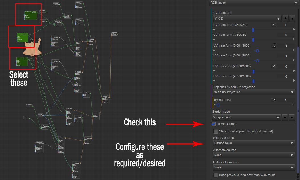

You need to open the relevant material in the Node Graph Editor. In the editor, select an image map that is tied to the material (it should be all the way on the left side). On the right, near the bottom will be a tick box for Templating, check it. You may need to unselect/re-select the image node to get the panel on the right to refresh (I usually have to). There should now be a few options for what you want the template to pull from. Select the settings that make the most sense for the given image map (tell it which material slot in Daz Studio it should be looking for an image map in, and then fallback/alternates, if desired).
Random infographic, in case that's a little unclear:
If you save that as a preset, much like I believe RedSpec shaders are set up (I don't have or use them, so I'm guessing based on what's written by the creator and faceoff), you would simply need to copy the preset to clipboard, then right-click and "paste as a template" on the surface(s) you want it on. This isn't limited to skins or anything. For example, I use this for hair, skin, car paint, and occasionally for other things like building materials (though rarely). I have always honestly thought templating was one of the coolest things about the plugin that never really got played up as much as it should have.
Oh, and you'll know templating is active on an image node as the node itself will turn green (as it appears in the above image). Likewise, if you have a templated material present, it will be prefixed by a green "T," for ease of reference at a glance (and in the quick edit pane itself when an image map is templated, it is highlighted in green with a "Template Node header above the image map in question). You probably already know a good portion of that information, but anyone not used to them might not know what to look for or expect.
