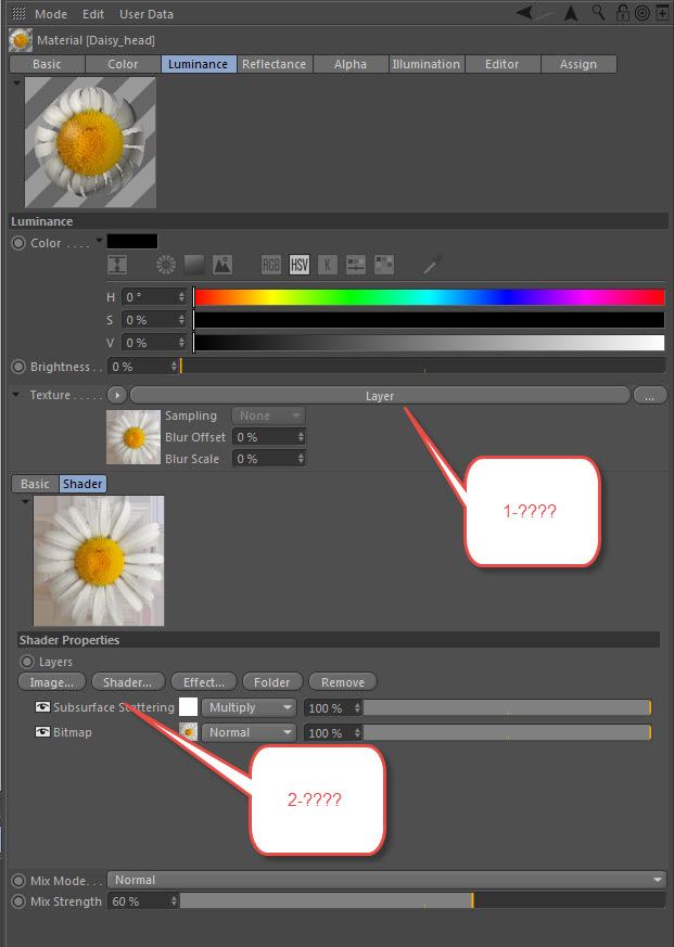

I think it's because of c4d standart material with c4d shaders.
I can't see any fixable stuff. You should not use c4d material/shaders as much as possible. Especially "layer". And what's the logic of "subsurface scattering" usage here? It simply crashes our "render-to-texture" engine.
Pls try to work with octane textures always. We'll have more shaders when osl version released.
ha ok . well the problem I got recently didn't involve SSS c4d stuff only few simple c4d mats . But yes i removed all those c4d mat (were native in an Xref loaded character ) to make it work
