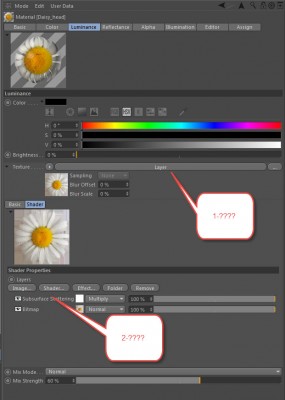

Hi , please find attached a c4d file + screen vid showing a problem I'm facing on a commercial project I'm working on where I need to scater flowers on a floor : I was using a mograph cloner to randomly spread instances of low poly flowers and when I tried to launch the render animation sequence , octane stops on frame 1 ( so calculate frame 0 but seems to start calculating frame 1 and suddenly stops ) . I found that the problem was one of the flowers mesh , so I isolated it to let you test . (this flower mesh was part of a commercial nature asset I bought , it's really simple and has 3 materials .. if you delete some , octane can render without stopping at frame 1 )

I can't see any fixable stuff. You should not use c4d material/shaders as much as possible. Especially "layer". And what's the logic of "subsurface scattering" usage here? It simply crashes our "render-to-texture" engine.
Pls try to work with octane textures always. We'll have more shaders when osl version released.

ha ok . well the problem I got recently didn't involve SSS c4d stuff only few simple c4d mats . But yes i removed all those c4d mat (were native in an Xref loaded character ) to make it work ;)
thanks.
