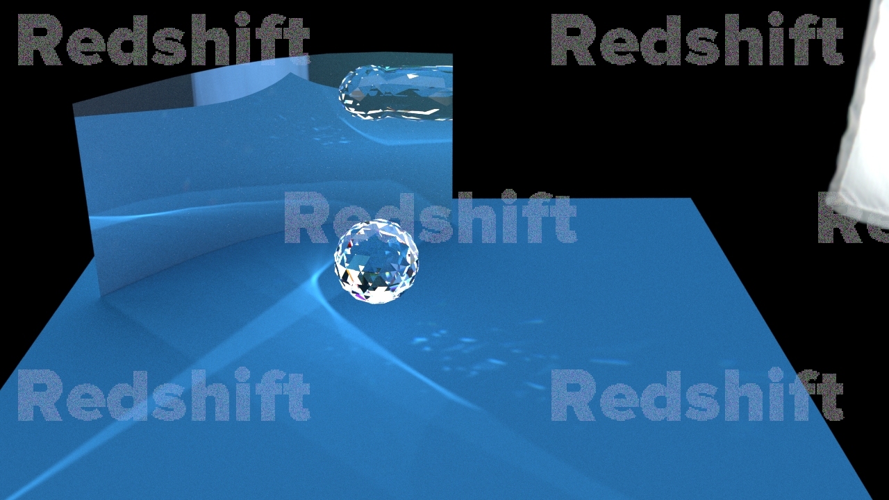

already two years have passed and the problem is not solved with a caustic - the other day I went to the redshift site and was surprised ... I understand that it uses a completely different type of adaptive .... but render speed 25 seconds, I was surprised at the GTX 660

@Goldisart: Thank you but Redshift has only up to 10 depthes while OR standalone up to 2048 depthes at PMC kernel.
Iray cannot make or makes very hardly indirect caustics at glass without roughness or bit roughness.
I do NEVER like any fake caustics!! :evil:
Therefore, I prefer OR!

Yes, PMС renders the correct caustic ... but if you animate a video caustical it is virtually impossible
............. for animation you need to use a fake caustic
