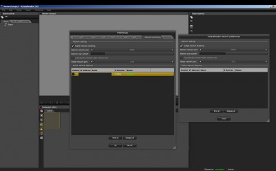

thanks, it was a firewall issue, right now i have 3.02 standalone installed but i get the "invalid version" error.
Is it possible that its becouse i'm using 3.03 cinema4d plugin version?
Octane standalone sees all of my slave gpus
- Attachments
- Untitled-1.jpg (28.77 KiB) Viewed 3388 times
Hi PiotrAdamczyk,
with c4dOctane v3.03.3-R1 you must have installed Standalone v3.03.3 on the slaves to match the same version.
ciao beppe
ciao beppe

The problem was with firewall blocking my other PC, i was also using the latest standalone version from the downloads page and not from the forum's thread you posted, thanks for the help guys.
