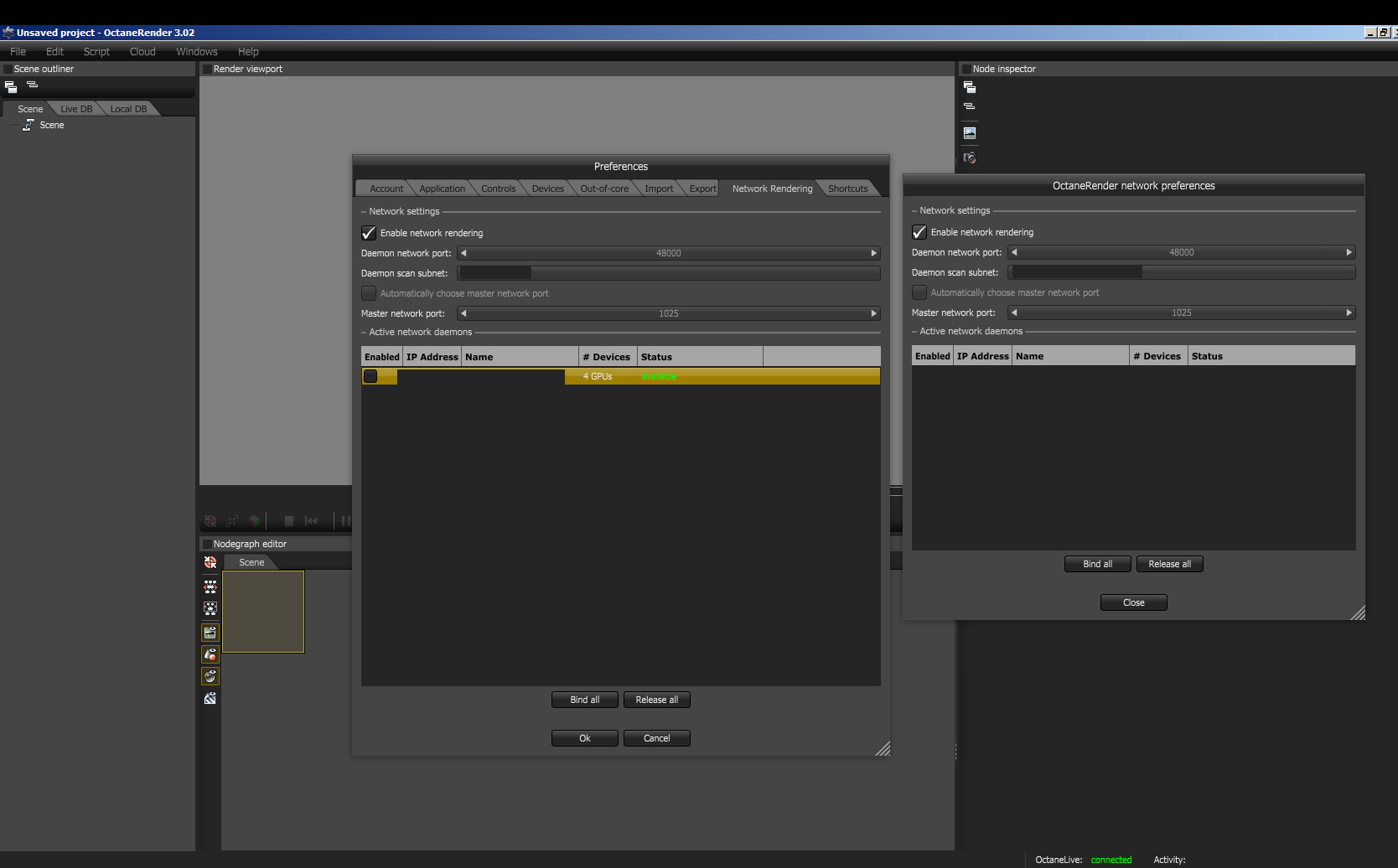

Deamons are running on both machines. I have octane standalone on both of them but i have only one c4d plugin license. For some reason standalone can see my GPU's but c4d cant see them.

could you try with only Cinema 4D active on the master and one daemon active only on the slave?
What do you see in Live Viewer info after loading any kind of scene?

i have octane deamon opened on slave, all octane versions are the same, standalone sees my slave GPUs but cinema does not.

thanks, it was a firewall issue, right now i have 3.02 standalone installed but i get the "invalid version" error.
Is it possible that its becouse i'm using 3.03 cinema4d plugin version?
Octane standalone sees all of my slave gpus

The problem was with firewall blocking my other PC, i was also using the latest standalone version from the downloads page and not from the forum's thread you posted, thanks for the help guys.
