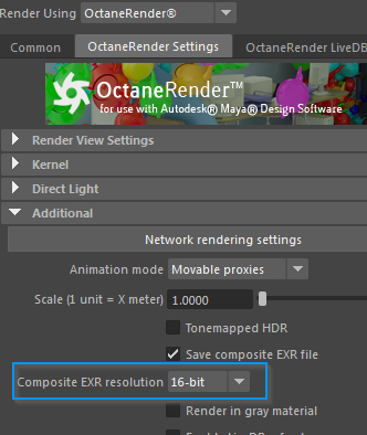

calus wrote: then if you enable "composite EXR" and select "EXR resolution : 16 bits", Maya will output compressed 16 bits half float multichannel EXR.
It may sound stupid, but I am not able to find the "EXR resolution: 16 bits" flag/check box/menu...where is it?
Sorry for bothering you so much but I really need to finish this work FAST :cry:

If you don't see this in your UI then you're using an old version that can only output EXR32,
I know the last V2 plugin in Download section is 7.14,
Kai should really update that,
the more stable version is the 7.24 :
viewtopic.php?f=109&t=53159
