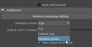

For batch rendering animation you may have to do one thing more :
Try to put the "animation mode" to "movable proxy" in render settings,
else if you let it to "full" all geometry is exported every frame, and doesn't respect geometry types.

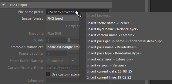

- render file path have a bug if you use dots in names or if you use sudirectory with Maya token, batch render doesn't work.

yes I know but you must put "animaton mode" to "movable proxy", this is not an object attribute, this is an option in render setting.
(read again my previous post, also added other ideas)

You should have tried first to change the "animation mode" in render setting, I guess this is your problem...

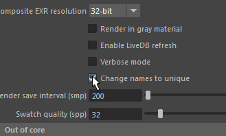

:!: Another issue I forgot is about object names,
if you have several objects with the same name you should use this option in render setting:
Else batch render is stuck.

By the way Maya token is about this:

So it Came out I am using the default token, <scene name>, so I guess this is the other major issue.

Maya token doesn't work only when using folders in the path so I don't think it's your problem (default works !)
