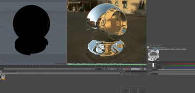

I noticed there was a 3D-Coat Metal node in the live DB, so built a metal material from 3DC and it appeared to work fine. Studied how it was built but when I create a new material and copy it 100% it does not produce the same results. In fact if I just use the 3D-Coat node material and just leave specular at default it is a very shiny metal, if I create a new glossy material within C4D and just have specular on it is a a shiny black metal. What am I missing?
This is the material made from 3D-Coat node in Live DB
3d-coat metal node
3d-coat metal node

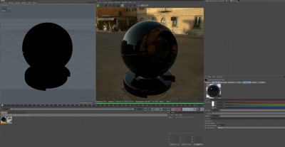

This is just a glossy material created in C4D
C4D_glossy
C4D_glossy

Should Index be 1.0 in first example.

aoktar wrote:Should Index be 1.0 in first example.
That was it, so reading the help, setting it to 1 removes Frenel and anything above it is just increase in Frenel?

@offrench thank you for the reply, I did in fact watch your videos, very helpful. It came down to index needing to be 1 instead of default of 1.3 within C4D. I ended up using standard Octane exports within 3DC for the C4D Octane plugin with no issues.
