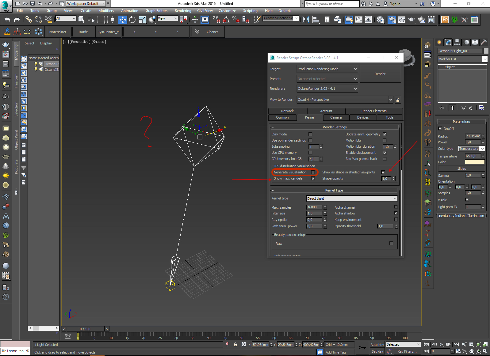

IES distribution visualisation (3.02 -4.0-4.5) not work

not work
3ds max 2016 SP3 win 10 2x 580 GTX
Last edited by Elvissuperstar007 on Fri Jul 08, 2016 7:02 am, edited 6 times in total.

The attachment Clip2net_160701115727_1.jpg is no longer available
certainly tried everything, it does not work

The 3ds Max viewport does not refresh immediately after you enabled this feature. You need to do something in the viewport to force it to refresh after changing these settings (e.g. pan the camera). And the IES visualisation generation must be enabled if you want IES to be visualised.
But there may be still some issues, that may be caused by some particular IES files - 'cause this feature is "brand new" and not all possible variations of files were tested.
If you have issues - attach please the IES file that does not show up to the bug-report.

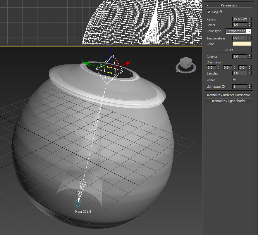

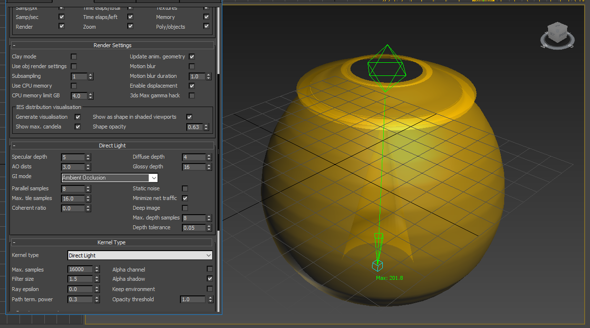

Your IES file:
Your scene:

Saramary wrote:Your IES file:
The attachment 1.png is no longer available
The attachment 2.png is no longer available
The attachment 3.png is no longer available
Your scene:
The attachment 4.png is no longer available
