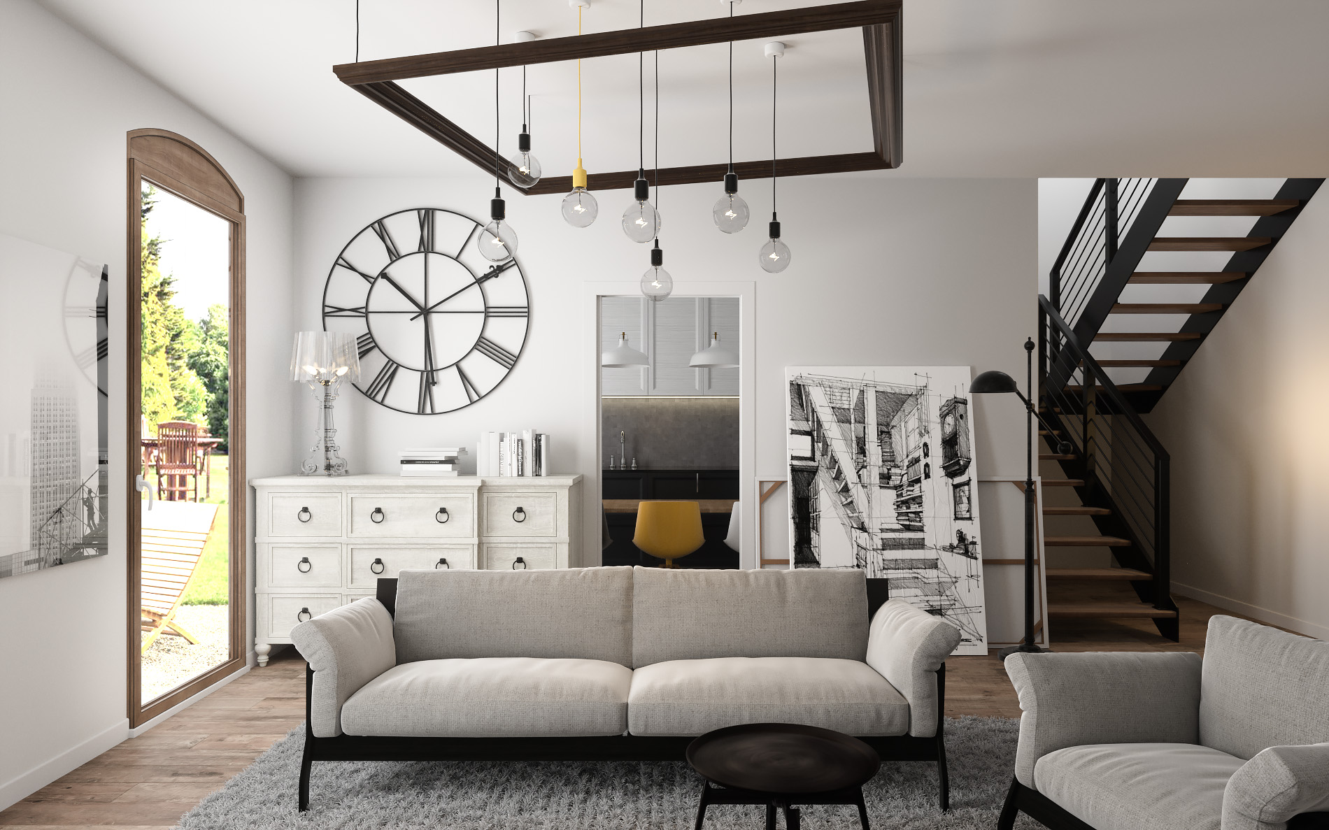

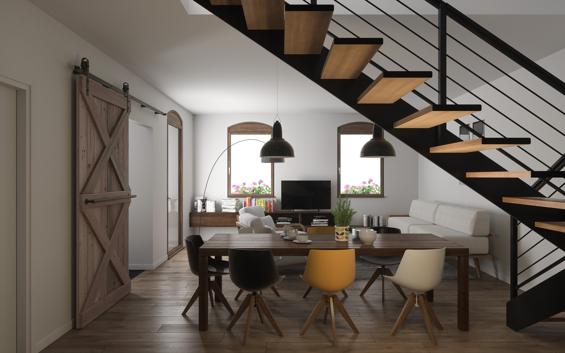

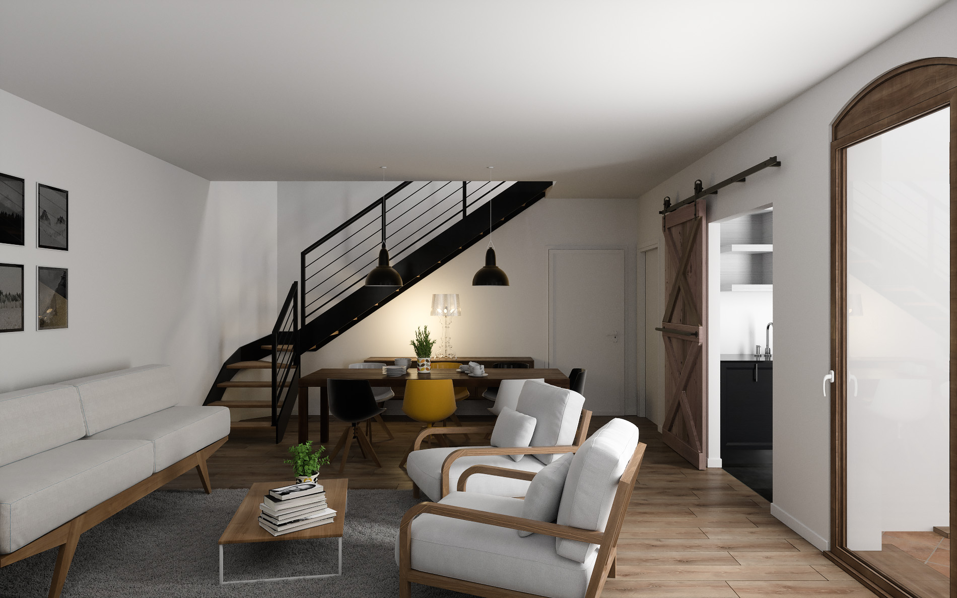

Here's another set of simple and quick interiors for a client.
Not really some sort of stuff I am proud of but I thought I'd share it anyways!
Path Tracing 4 bounces, around 9 mins per image on a gtx780ti + gtx970.
Greetings!
M.

Very clean for 9 min cooking !
I guess you used emit planes on windows.
Did you used specular material for windows or glossy with low alpha ?
Great result

Thanks!
Yes I used light planes at windows!
As for glasses I used a fake glossy material, I see now that I even forgot the glass plane in some shots, I was in a hurry :P
Best wishes,
M.

They're indeed looking very (too ;) ) clean for only 9 minutes. Ceilings and walls look perfect!
Did you do any post work or are these raw renders?
Can you share a basic max scene with your setup/settings? Maybe this scene without furniture and textures?
I know about your light planes, but just to see the general scene setup (response filter, white material value, settings)

RobSteady wrote:They're indeed looking very (too ;) ) clean for only 9 minutes. Ceilings and walls look perfect!
Thanks RobSteady.
I have attached a typical scene of mine (without the furniture due to file size).
Usually for interiors I use linear workflow with gamma 2.2.
My postproduction actions usually are on curves, sharpen, and saturations. So the raw renders looked pretty like the final ones, just with less contrast. I barely have the time to spend on post production, so I tend getting the most out of octane.
White material I use for interiors is 200\200\200.
